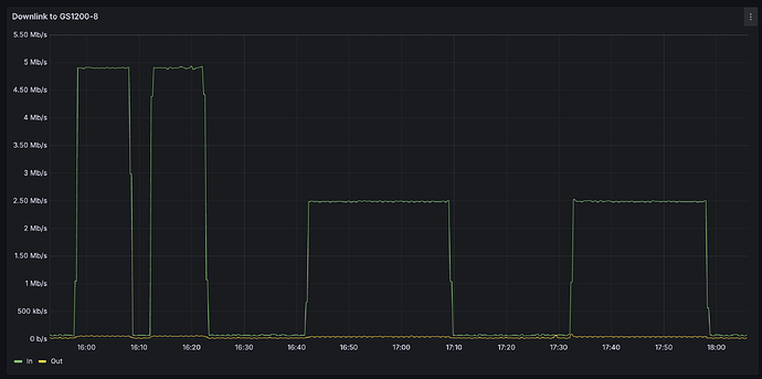

Diretta’s example demo graphs for their “improved” stream made me look at my own network, which is comprised of daisy chained Ethernet switches. Here’s a graph of a downlink to the switch where my Pi endpoint is, nothing but RAAT. They look cleaner than the demo graph on Diretta”s website.

Interesting…that can’t be good for latency? What problem were you attempting to solve by daisy-chaining switches?
