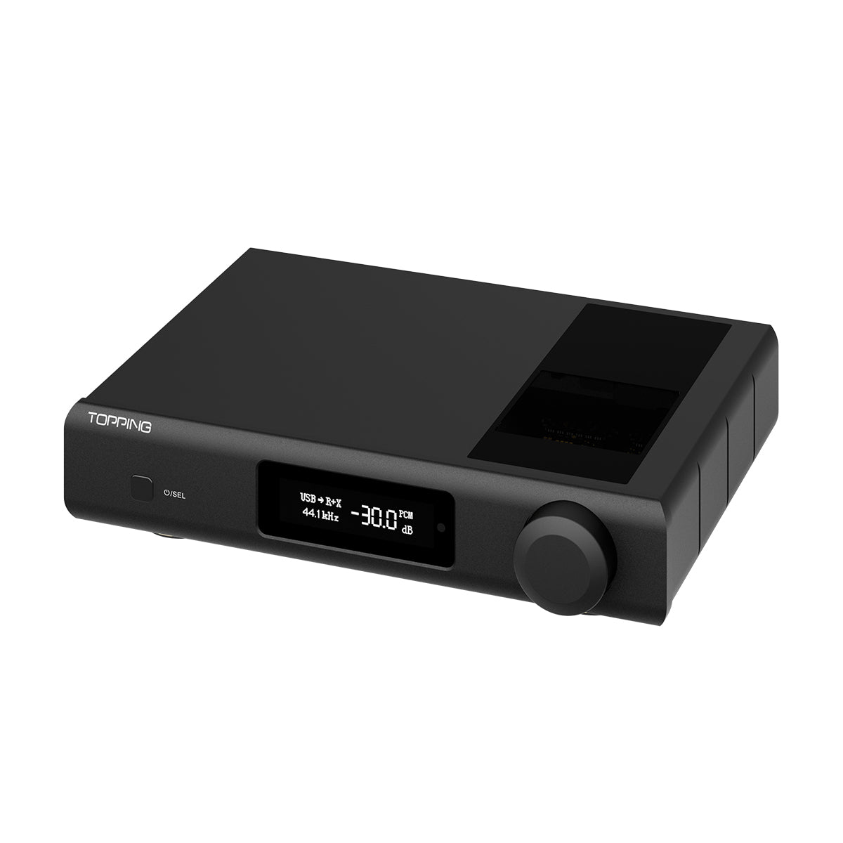

Off topic but does anyone know if this new Topping DAC would be okay to use with HQPlayer?
Its using 1 bit non IC and am curious if it can be used effectively what would be some mandatory or recommended settings in HQPlayer.

im interested in this DAC to acocmpany a Topping A90 discrete amp but am against it if it wouldnt work properly with hqplayer ![]()

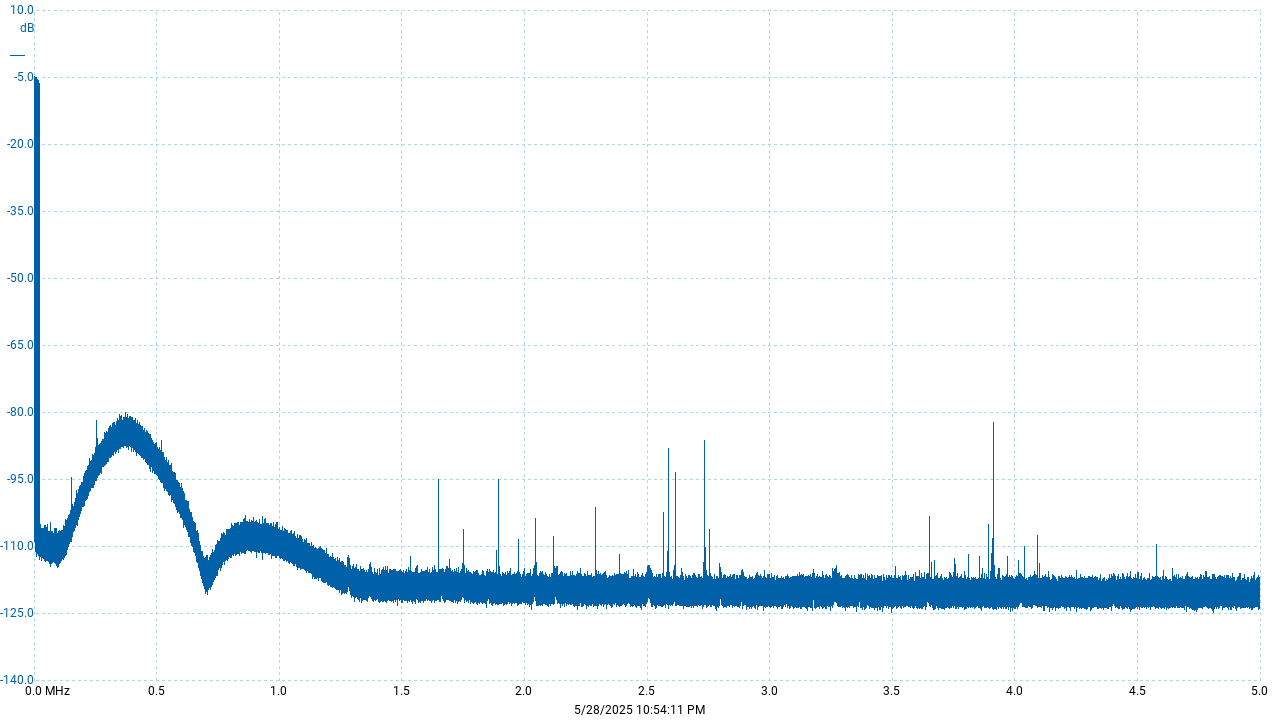

OK, now I’ve done some measurements. Doing all is not possible, because the DAC misbehaves enough that some of the tests go broken. (latest firmware installed)
But I can tell that it is not a Direct DSD DAC, even though “DSD Bypass” is enabled which is supposed to turn it into one. Maybe this has AK4191 or some other similar chip as a front-end?
It is quite apparent from wideband measurements…
Sweep with 44.1k PCM input:

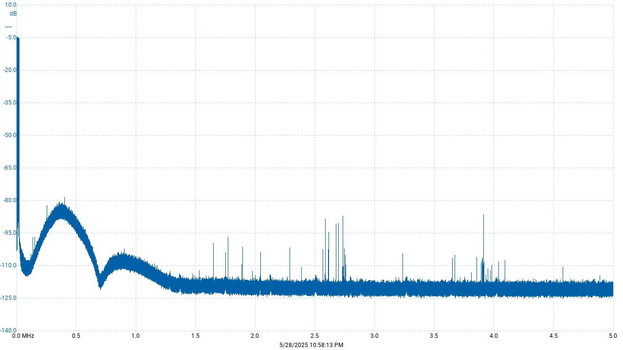

Sweep with 7th order modulator at DSD256:

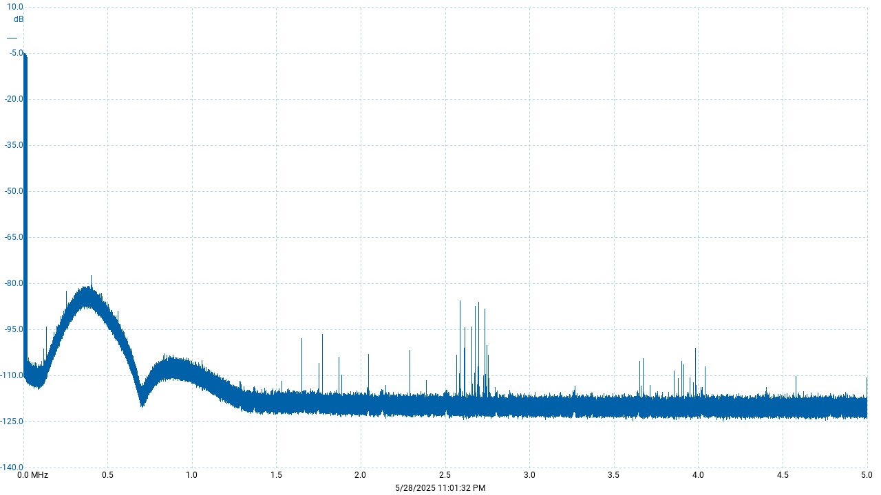

Sweep with 5th order modulator at DSD256:
It all looks the same, while of course it shouldn’t!
