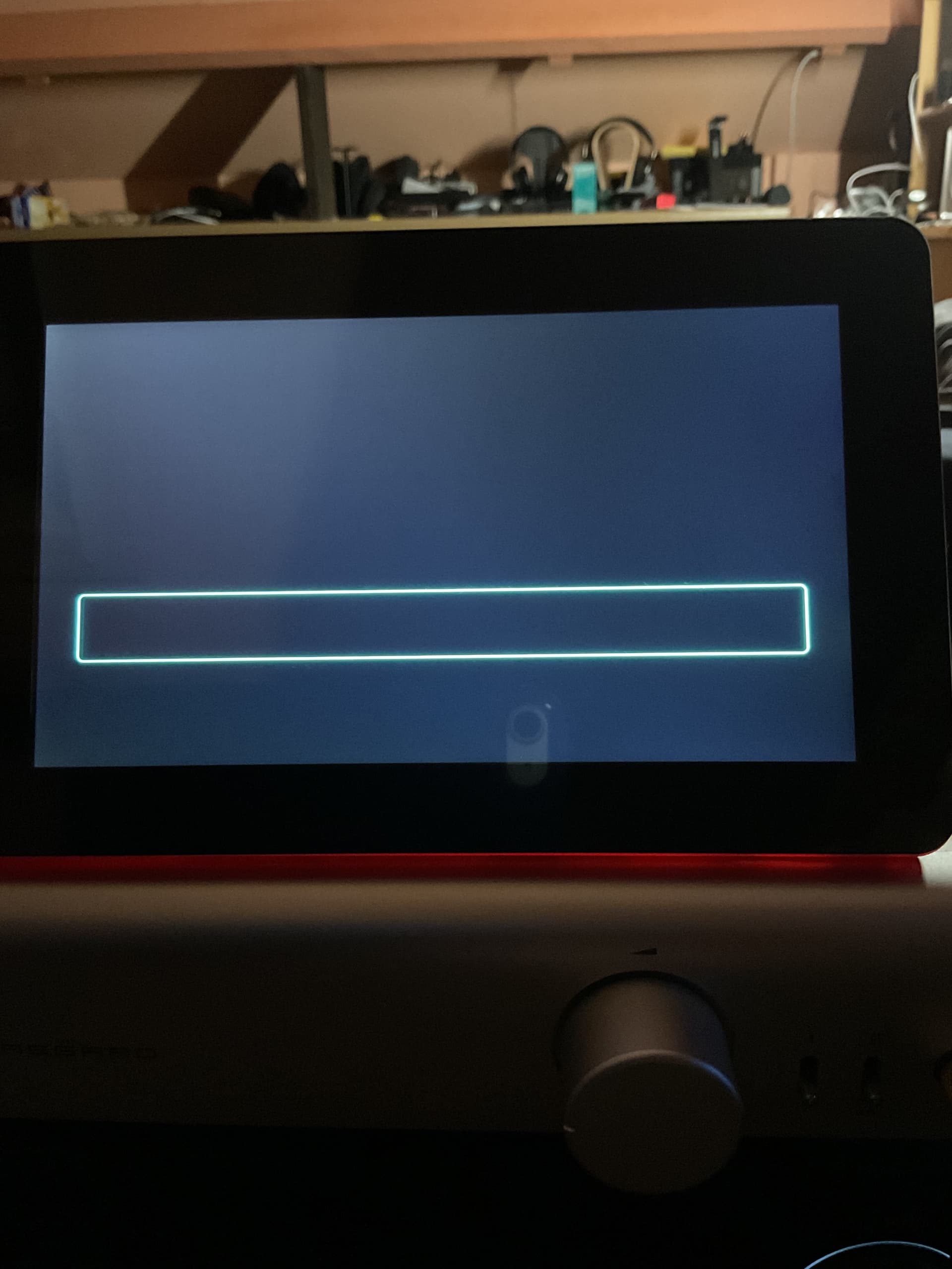

When come on active Roon screen it is nog showing all, only the frame lines, no text or pictures.

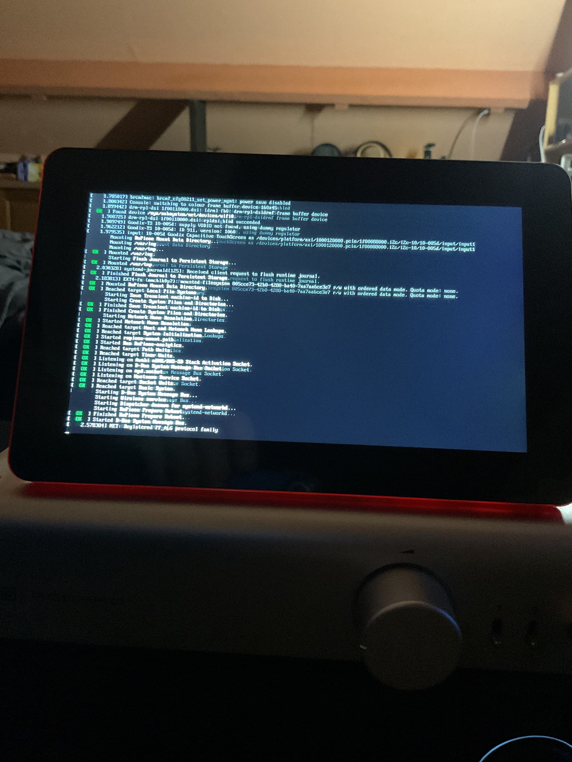

All the boot text is showing, Roon screen also but without the text and pictures, only showing the square lines where in the picture supposed to be.
Yes, all the same steps as in the now working Pi4 setup
The small square you see, is normal showing the text that you have to select a Roon zone.

I took all the steps by both a pi4 and pi5 setup. Both get working but pi5 shows in Roon no text and pictures only the square lines where in the picture should be.

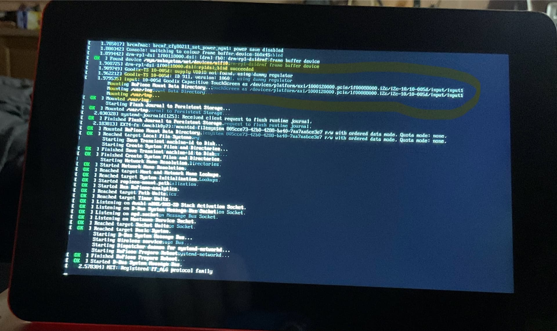

I can reproduce this issue on my rpi5 with touch display 2. On start up the pi does show a warning that the frame is not recognised: ” Unknown Frame: category 0x5, action 0x4.”. I sent feedback on d0915538f11d2c44.
Could you have a look?

At boot, I get line that screen is recognised, see picture
I might still be on 2025.06.0 but will check later. It is on display 0 port.
