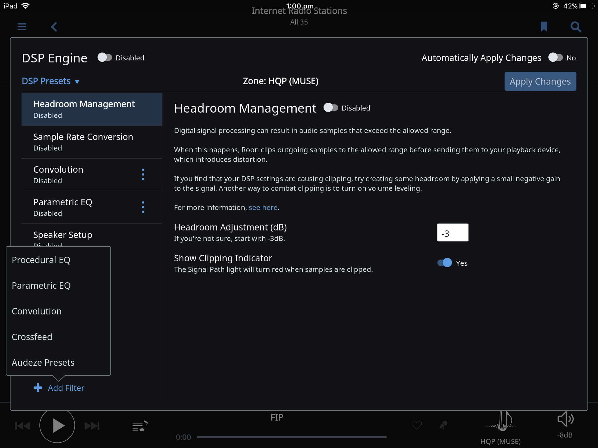

Hi Steve,
First, check that in Device Setup/Channel layout your Soundcard Zone is set to 7.1 channels.
You’ll find the Mix tools in:
DSP Engine/Add Filter/Procedural EQ
Procedural EQ/Add Operation/Mix
The Mix tool should enable you to map L/R Stereo inputs to desired 7.1 Channel Outputs.
