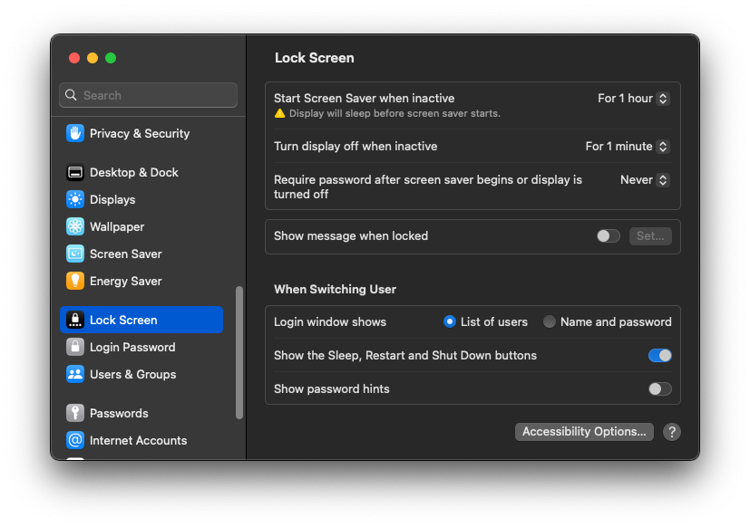

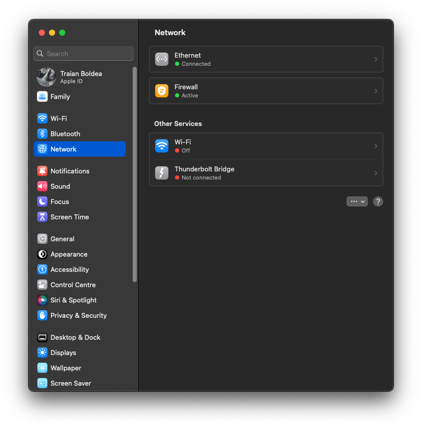

Hi, I’m on a m1 Mac mini, updated to Ventura 6 hours ago, also using the Mac mini only from my iMac with screen sharing. For me it looks like a sharing problem, on OS X. It happed to me, same and others. A Mac mini restart worked sometimes. Other times just had to revisit all the system setting on the Mac mini.
If you need I can give you screenshots with my settings

No, I do not know all the settings for keeping awake, usually roon plays music 24/7. Mac mini is only running OS X and roon, I do not use it for something else. So all the things are off, wifi, Bluetooth, Spotlight, Notifications, etc
The only thing that I did today, I noticed the new system prefs in Ventura, and did allow roon full disk acces. I’ll close my roon now for ten min to see what is going to happen. Just tell me specific if you want me to look for other settings. Also: I run roon server on Mac mini and the full ap on iMac

Searching Ventura sistem setting I found another option:
Thanks, this setting I did not find so far, so I will give it a try. If you keep your core playing music overnight, I assume you will have no issue in the morning. Playing should keep it alive, I guess
