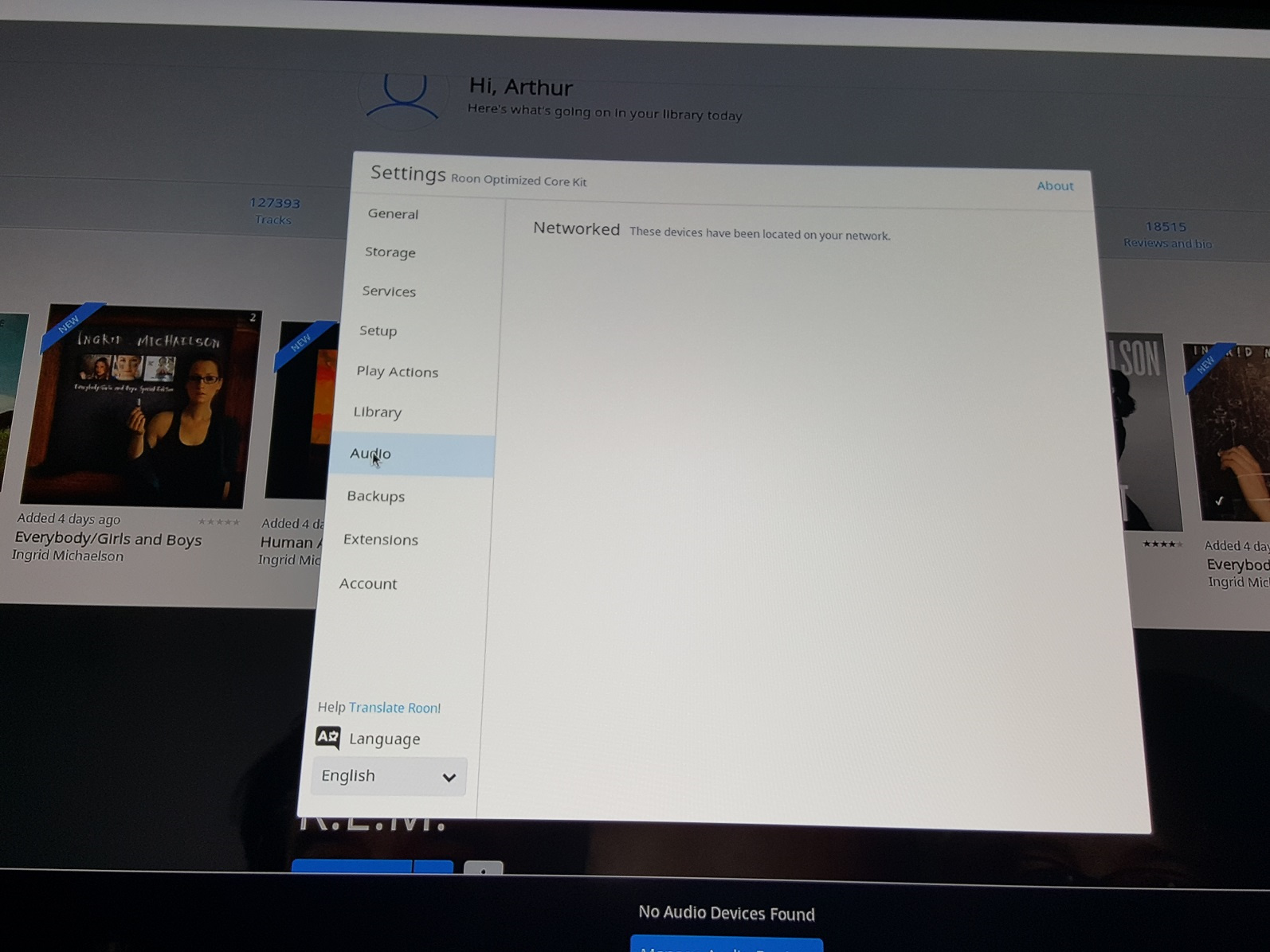

Yes, I uninstalled the Roon app and reinstalled it, same results. I want to once again point out that this exact configuration worked flawlessly thru the 2-month trial. I changed nothing. My trial period was about to expire, it was giving me a warning in the top right corner of the screen (near the bookmark icon) so I contacted Roon to ask why my lifetime membership, purchased back in February, hadn’t kicked in. Roon made a change and everything stopped working.
I am using a Remix Android PC, basically an android tablet in a box, to run the controller app. The Roon core is running on a i7 NUC (ROCK) and my Roon Endpoint is an Oppo UDP-205. Below are the screen shots.

OK, I solved it. I accessed the ROCK via the web browser interface and used the “reinstall” button to reinstall the ROCK software on the NUC. Once it was done reinstalling I was able to see the Oppo from the Roon Controller App.
