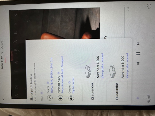

I have just hooked up my Roon Nucleus after a years absence. I have an Aurender N200 which is now Roon compatible. I have both the N200 and the Nucleus plugged into my router. Roon sees the N200 and I can select it and the music start and the N200 shows music playing in the Roon app, no problem. I just don't get the sound coming out from my speakers. When I switch back to the Aurender app the system plays fine. Has to be something simple. just not to me!
I have a Netgear CM10000V2 modem connected to a Netgear R6700AX router. Cable to modem, ethernet to router, One ethernet cable to the Aurender N200 then another ethernet cable to the Nucleus, with 19V dc powering the Nuclues. Then a USB cable from the N200 to my DAC, onto the amp and so on to the speakers,

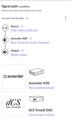

The second picture below must be the DAC.
Thank you! So, what am I doing wrong? I have the DAC connected to the N200 via USB, why do you think it’s not showing in the signa path?

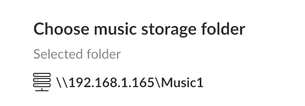

And once I figure out the first problem, how do I access the music that’s on the hard drive that’s in the N200?

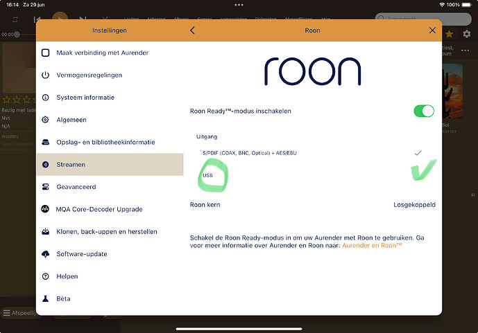

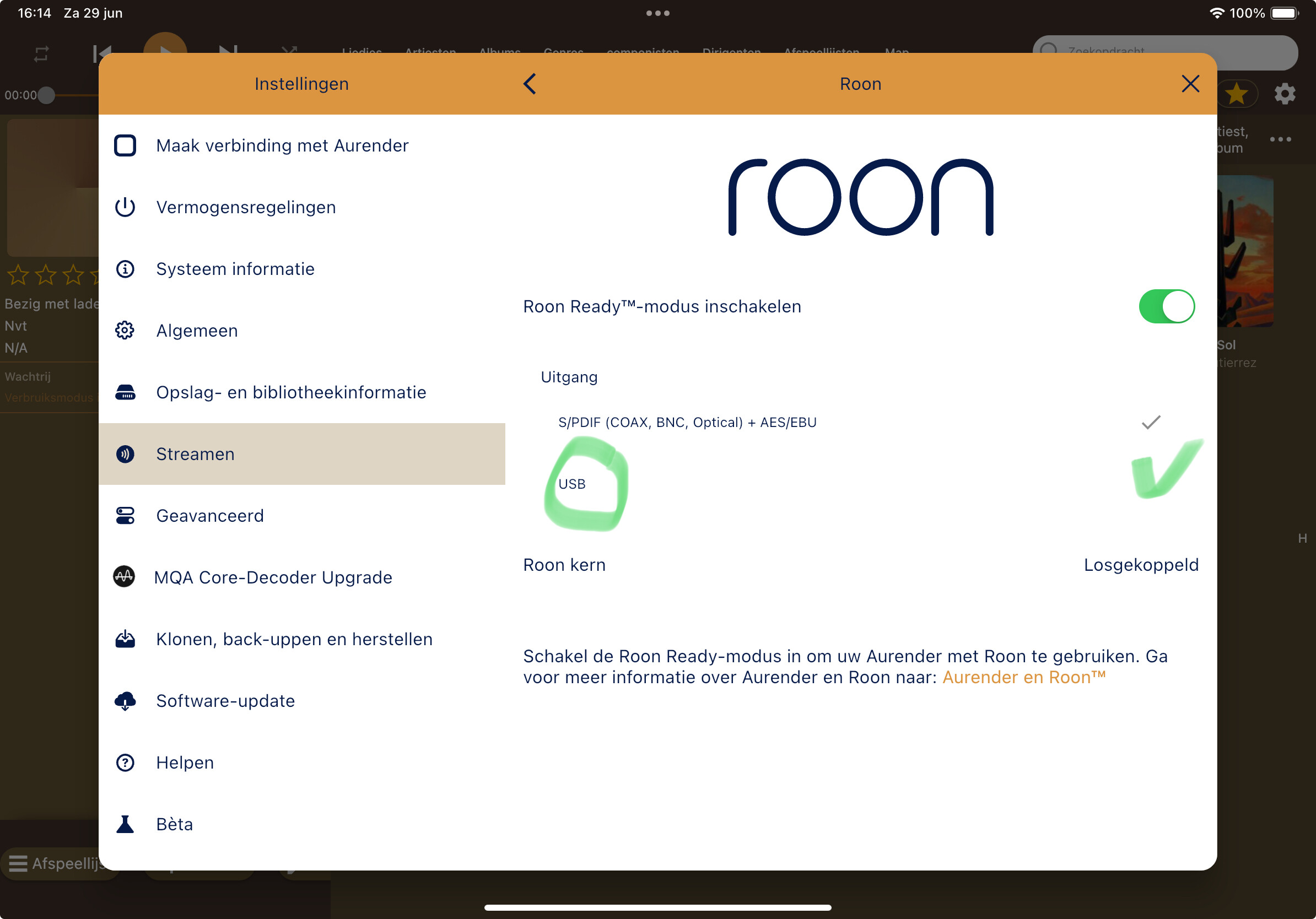

Did you select USB output in the aurender app?
Make in Roon a connection to your music on th Aurender
IMG_0540
Hmm, probably not, I will go and try. Thank you for all your help!
You have to look at your ip number in de Aurender app

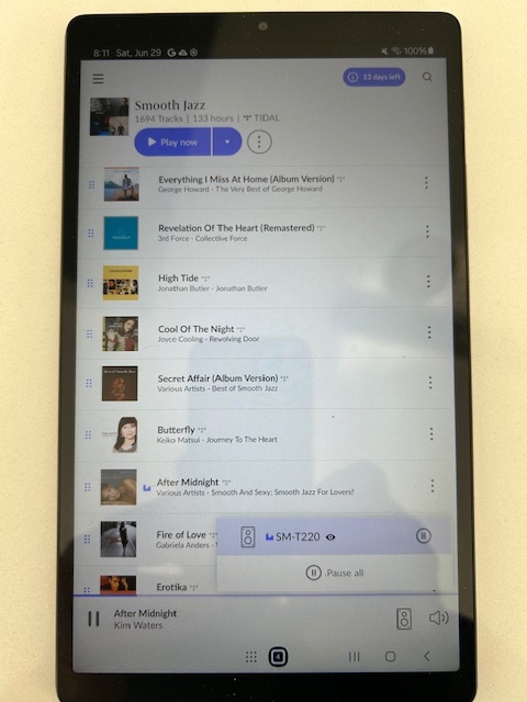

OK, I changed the output in the Aurender app to USB, then I also added the ip address to Roon app but now I have lost the N200 on the signal path display. It only shows SM-T220 and I don’t even know what that is? You can see that Roon is somehow acknowledging the N200 though, as you can see the Conductor app at the bottom of the Roon screenshot. Weird… I will keep playing around with it though, thank you!
Add i
mages
I figured out what the SM-T220 is, it’s the android device that I have the apps on, so at least I’m getting music to my tablet! LOL
Because you switched from output you must go again to settings/ audio en choose the aurender usb connecting
OK, after hitting many buttons, clicking on this, clicking on that I finally got it playing on the N200, again, thank you for your help and guidance!

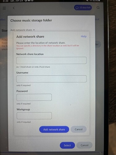

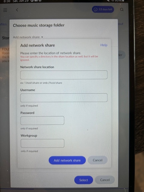

Could I trouble you a little more about accessing the hard drive in the N200? Is the screenshot attached here getting me to the right area?

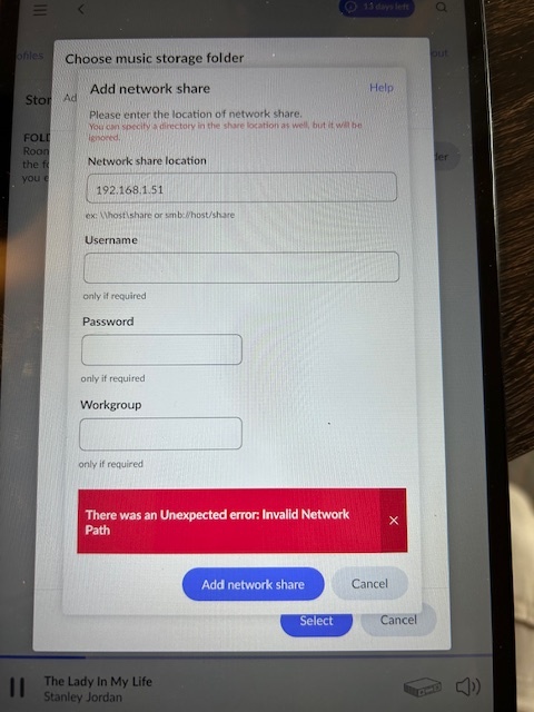

I guess not, I put the ip address in here and got an error message.
Try this
https://ask.aurender.com/hc/en-us/categories/1500000245081-How-To-Guides
Sorry, wrong picture and OK I will check out the link that you sent me. Thank you
IMG_0540
Exact like this with your ip number, then
Username aurender
Password aurender
OK, the link is a little confusing but your directions on your last message look great, I will try that first!
Fantastic! I finally got the N200 hard drive added! I’m not much of a techie, so I struggled with issues outside of what you advised me on. Thank you for your help and patience. Coffees on me next time you’re around Ferndale, WA.
