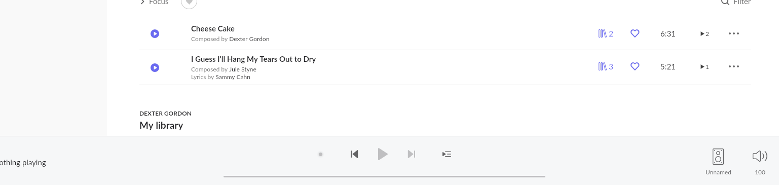

No audio from Roon player but Audacity plays the same files without a problem
I am not hearing audio output from a small number of files when played through my Roon Server / Roon players.
These files were originally encoded by “X Lossless Decoder 20130407, QuickTime 7.6.6” and work fine when played back using Audacity so I know there is nothing corrupt about the files. I’ve also imported them into iTunes/Apple Music and played back the files without a problem.
Roon Server (on SYnology) -> Mac OSX Roon client
Roon identifies these files correctly in the Roon Browser but produces No output when I attempt to play them using Roon (immediately gives the “Northing playing” message.)
I’ve attempted to transcode these into WAV format but Roon still doesn’t produce any output when I try to play back the WAV formatted files in Roon. (“Too many failures. Stopping playback”).
How do I diagnose the failures that Roon is getting and fix the issue in Roon?
