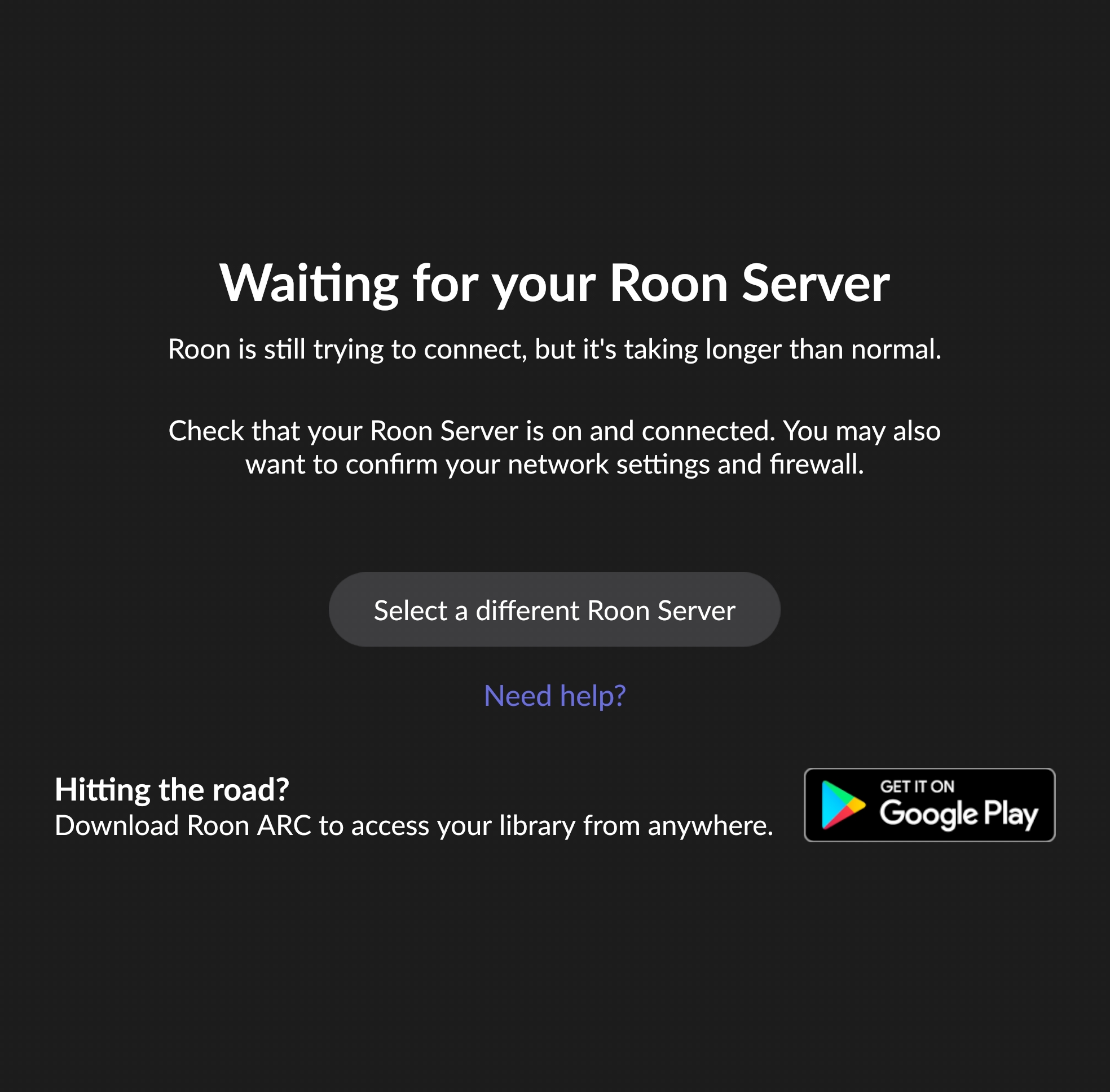

No connection to Nucleus One via Roon app on Android smartphone (ref#0AY3NQ)
Is Roon Server running?
· "Waiting for your Roon Server"
What happens if you press the "Select a different Roon Server" button?
· I don't see Roon Server.
Please try to restart your Roon Server by closing the Roon app in the taskbar or rebooting your Roon Server machine.

No connexion to Nucleus One with the roon app (on an Android smartphone).
My router is a Livebox 7 by Orange. I have a network base on powerlin adapters (CPL in France) running perfectly for every device connected.

Meanwhile I did a reset of data and settings from my PC.
And when I tried again on the phone I was given the choice between Nucleus One or my prior PC core.
After choosing Nucleus One everything started correctly with my phone and with my tablet too.
So everything is fixed, but how can I delete my prior PC server which doesn’t exist any more but was still a choice when I restarted Roon.
