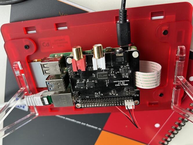

Not, unfortunately, in my case. No optical audio coming from the toslink port. Maybe because mine is a Digi2 and not a DAC. But the display works. From where is the audio coming out in your configuration and how do you feed the display, Feank?
Iā€˜m using the cinch outputs from the DAC
Yeah. You have a different HAT. Mine is this one https://www.hifiberry.com/shop/boards/digi2-pro/
Indeed I tried to use the Jutboom Digi driver too, but no luck in getting the optical audio. I also tried to buy that JustBoom Digi hat but could not find it anywhere. But thank you for sharing!
Just as a heads up - I’m having the same problem with a HiFiberry Dac2 HD (Raspberry Pi4b) the bizarre thing is that with (I think) identical components in a different device, the display works fine with the correct HAT selected in RoPieee
After a LONNNNNNNNg session of faffing around… time to buy a new HAT I think :slight_smile:
