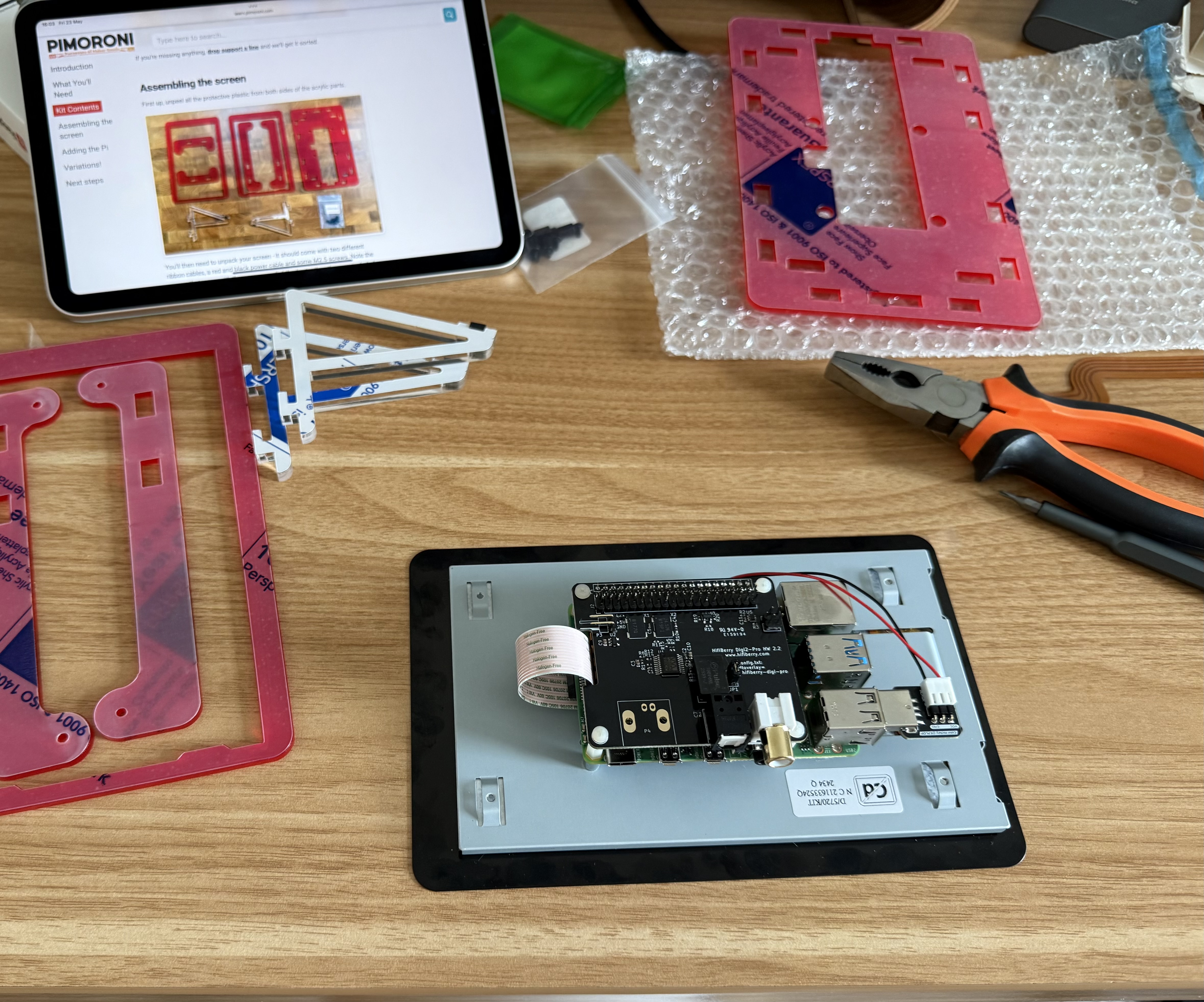

My setup has been already added successfully to Roon. But the display is black. This is my setup and the way I have assembled it:
  • Raspberry Pi Touch Display 2 (connected to the Pi Rasp 4 via USB Power Breakout for Raspberry Pi Touch Display 2)
  • Raspberry Pi 4 Model B
  • HiFiBerry Digi2 Pro V2.2 on top of it (this is why I had to give the power to the display through USB)
  • Raspberry Pi 45W USB-C Power Supply. Is this enough for everything? From my calculations (and chatGPT) it seems yes. I really wanted to have one cable for everything.
I have installed it today and the RoPieee 2025.05 (2453) [STABLE]. At the first boot I saw the usual kernel starting then display went black. I sent logs through feedback from the Advanced tab (identifier 45b7769ad1e010fe)
During the installation I see some instructions on the display, then nothing.
Any idea?

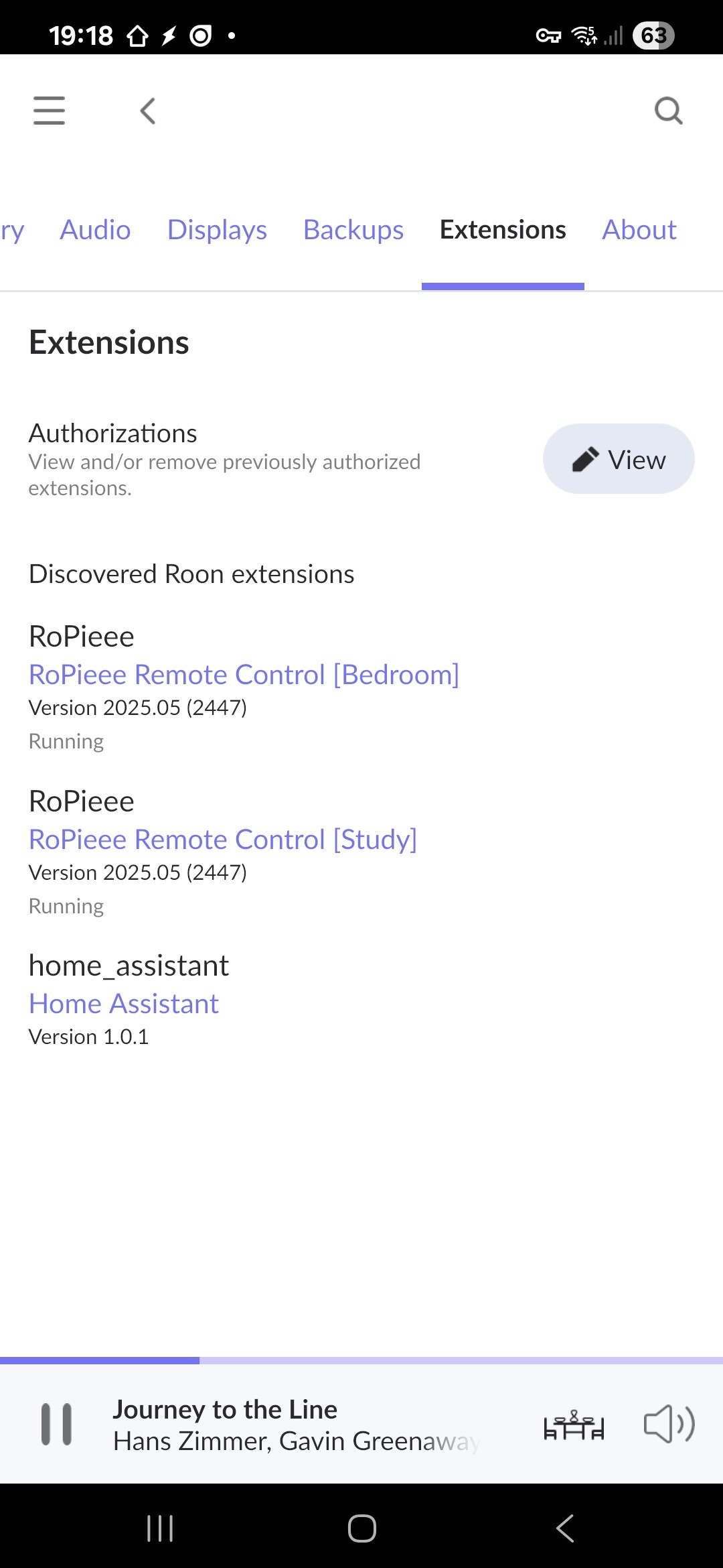

Have you enabled the extension in Roon?
Thanks James, and yes. Everything seems alright there, and correctly assembled. I’ll re-flash and re-install…

It could be. Because the display is ON for a few seconds during the first OS installation, and I see the kernel showing messages (no errors) about configuring the display then black. No clock.
And Frank, yes. I configured the display, changing from autodetect to the display 2 and other options…but after the reboot I see nothing. All components are new and checked the compatibility in the Ropieee pdf guide…what a pity having this problem.

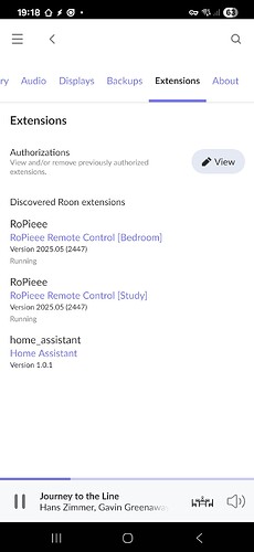

To be honest it still sounds like you might not have enabled the extension. In Roon, go to Settings - Extensions like the below image. That said, I think with the extension disabled the screen should still show “something”
That’s not the case: if the screen is properly working, and you have not enabled the extension, you get a clear error message on the screen about this.

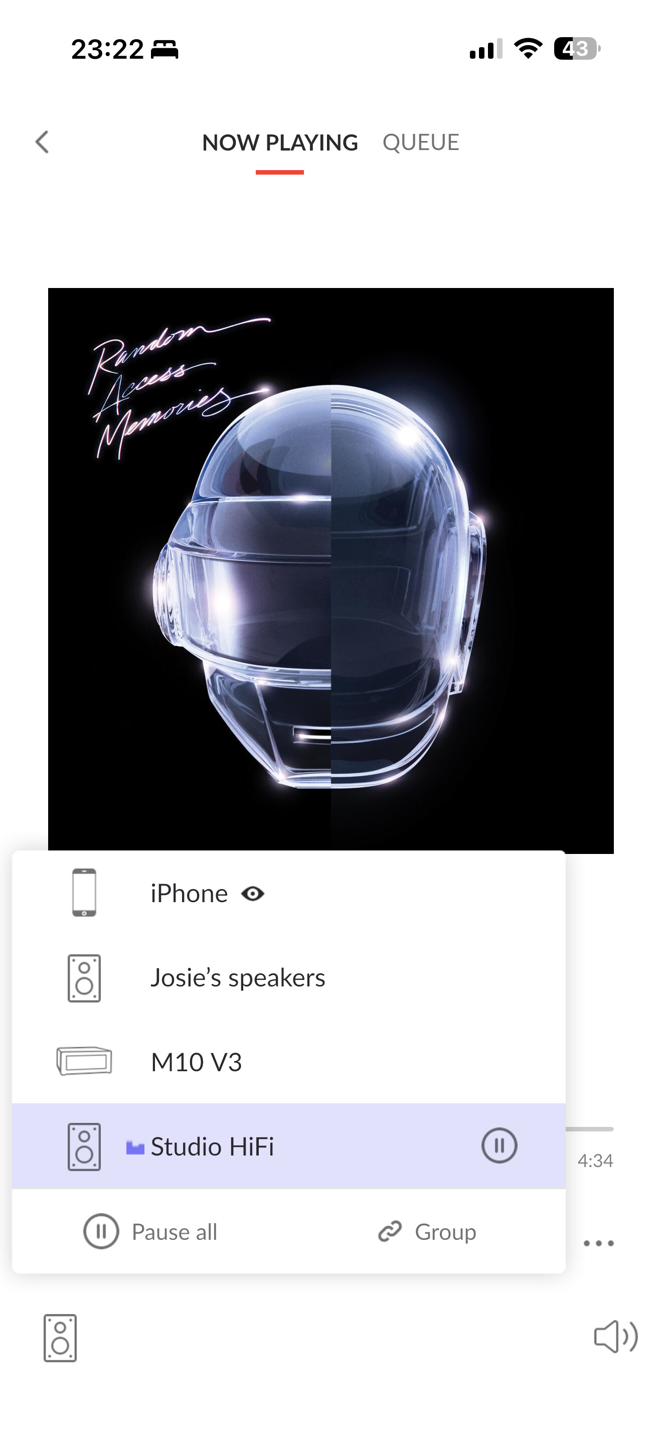

Thanks for your help, guys. The extension is enabled and can see the toslink output activating if I play a song with Roon.

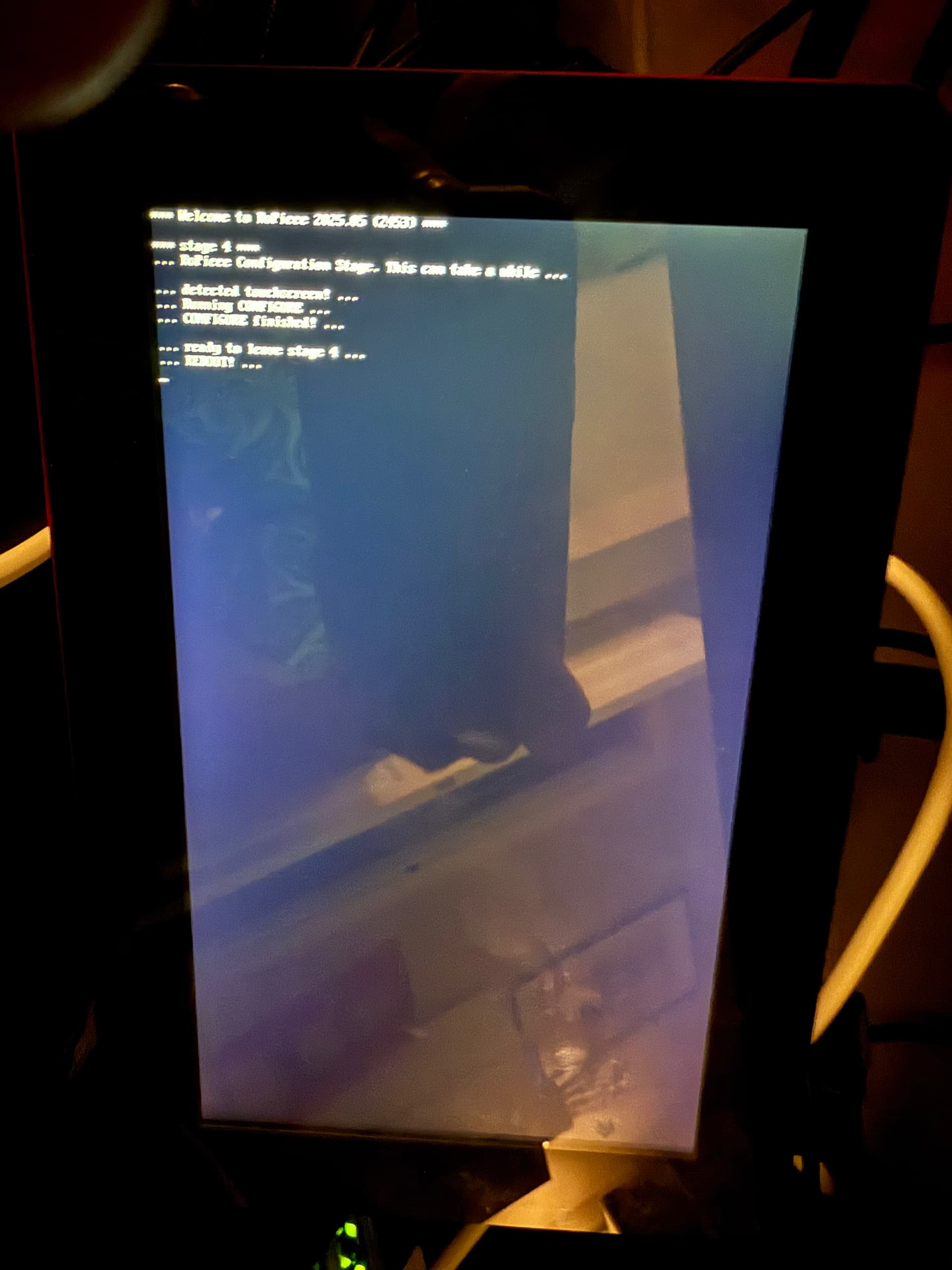

  1. Display with power coming from a separate adapter. The display is black after these messages (apologies for the poor quality, you should be able to read the latest info messages)
  2. I removed the HiFiBerry Digi2 Pro V2.2 after shutting down everything and the display works now taking the power from the Pi Rasp 4, like in the guide, and it worked.

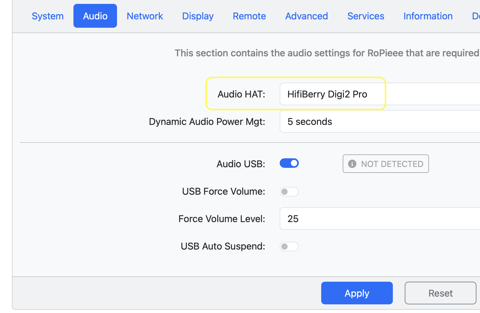

I confirm that, even when the HiFiBerry Digi2 Pro V2.2 (version not indicated in the list) is mounted (and feed from the PI Rasp 4 through this), the display stops working only when I select that hat via admin view.

  2. Another fresh installation, following the guidelines below but the display is not working:
(I have cross-checked disabling the HAT in Audio section, and leaving “No HAT configured” makes the display works…but not the rest). Is it an overlay issue or what? Any help is welcome. Happy to send diagnostic logs through the Send feedback functionality.

There’s probably a conflict between the Digi Pro driver and the Display. You’re not the first to report it, with this specific HAT. Not much I can do about it…
The v2.2 uses the same overlay as ‘the original’ one, so no difference there.
