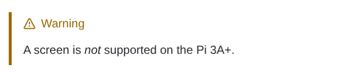

I happen to run into the same issue: On a setup running ropieee stable for a long time (pi 3a, official 7” display) that i needed to do a clean re-install on, the display tab does no longer show up. The display itself shows all boot msg, but ropieee does not detect it. I did 3 re-installs and changed the pi3 to a factory fresh one with no luck. Triggering configure does not help either.
Have a look at the connection. Assuming you’re running the latest version. But check wires first
I am on 2026.04 did 3 fresh installs and tried 2 pi 3A boards. I did re-plug the ribbon cable 2 times on both ends, always with the same result: Boot msgs visible, display not detected by ropieee.
I did the initial ropieee setup using the built in AP method as the pi 3 A has no ethernet.
On a separate note: Does the AP setup method set the right wifi country code?
I just read your message…
From the documentation:
So that’s the reason. On the Pi 3 A+ this has been extremely unreliable, hence this message.
Ok thanks. Sorry for not catching that. I did run that setup for many months without any issues so i never checked the docs. My bad. I swapped in a pi 3 B and after one configure it works again.
No worries. Before 2026.01 the Pi 3 A+ was actually never supported formally, but ‘it just works’. During the cycle of 2026.01 it became clear that with the newer kernel there were serious issues with screen support, so at that time the choice was: do not support the 3A+ at all, or support it but without the screen.
But glad we sorted it out. I initially also missed your remark about the 3A+ so…
