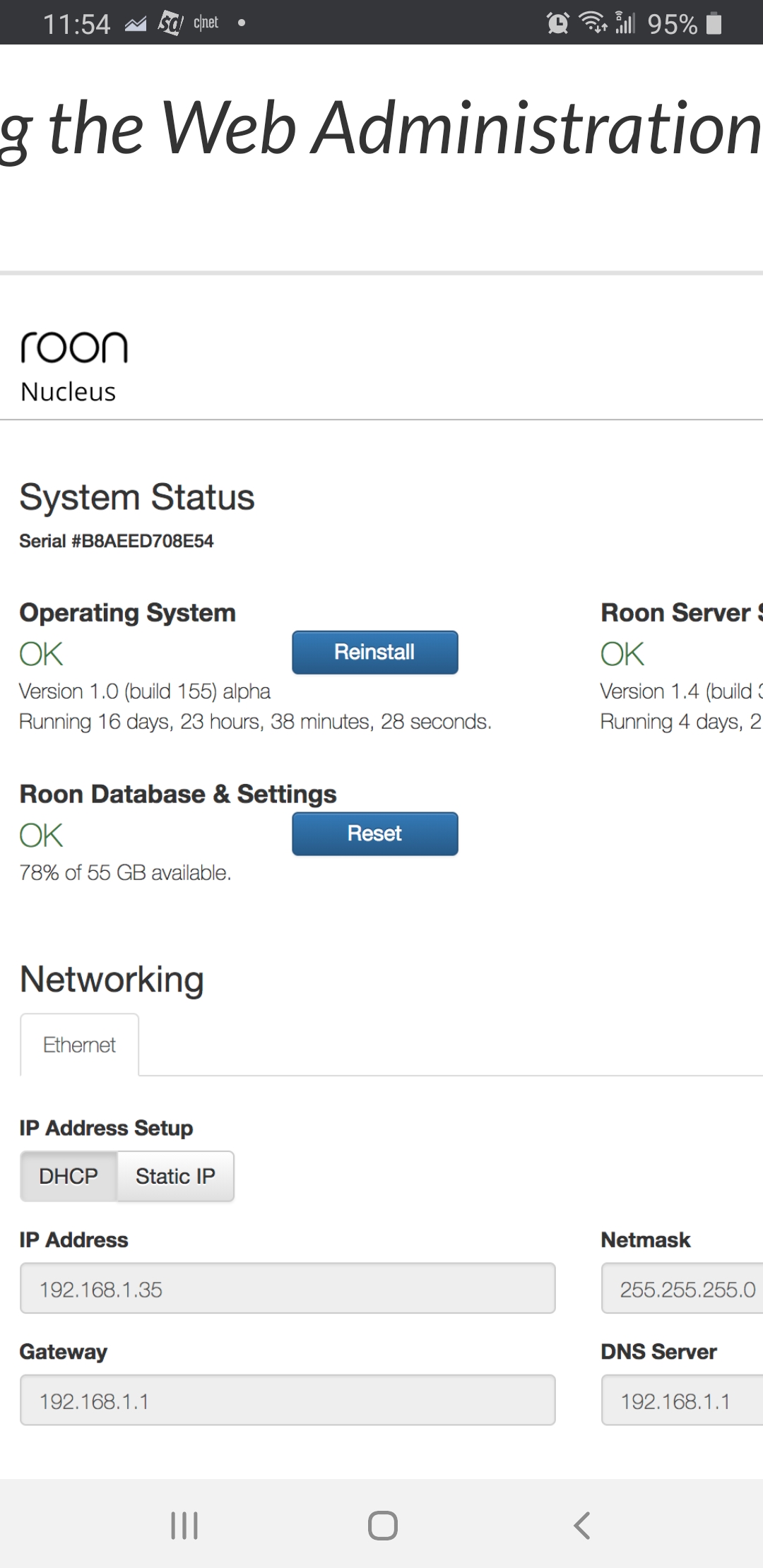

If you’re recommending reinstall the OS, I already tried that.
Hi @Adam_Gorberg,
Reinstalling the Nucleus OS does not set up a fresh database, and this is an issue with the database itself. To set up the fresh database, you can use the instructions I linked above (best method) or press the Roon Database & Settings -> Reset button on the WebUI.
