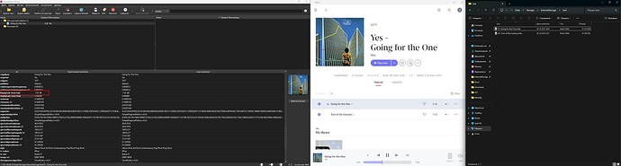

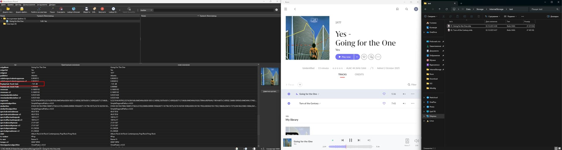

I just checked your files on both my Windows and Linux server setups, and I do not see any issues with playback. Please note that ReplayGain tags themselves do not affect whether a track can be played – they are only used for volume leveling once playback is already working.
Could you please confirm whether FFmpeg is correctly installed on your server and accessible by Roon? This is required for certain formats like AAC/M4A.
