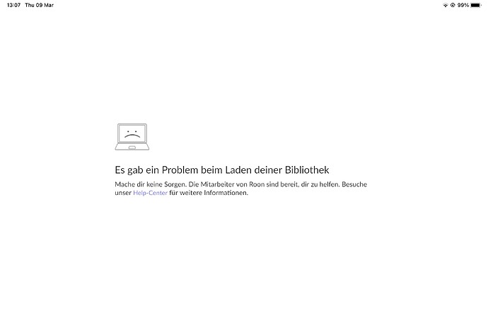

Today it first worked, then lost connection (first picture), then connected after several trials but couldn’t find the Dynaudio Connect like before. No chance to connect any audio (second picture).
Actually it doesn’t even connect.
