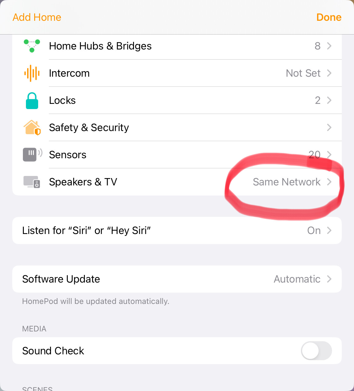

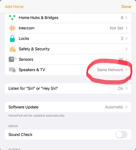

Check that you have AirPlay allowed to any device on the network.
Open the Home app, choose Home Settings…
Check that Speakers &TV says Same Network.
Just a thought…since it used to work, it probably isn’t this, but it happened to me once.
