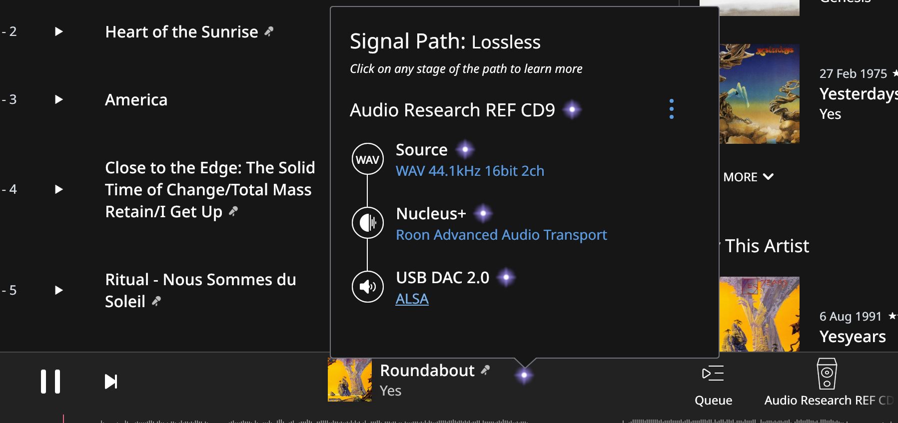

I just purchased a new Roon Nucleus+ to be used as Core, which replaces my Mac Mini which was used as a core. Of note is that I’ve been running the Mac Mini Core connected via USB successfully to my CD/DAC for several years. Nucleus is now connected to BT hub, Microsoft Surface Pro connected via WiFi network. I’ve updated Nucleus to latest firmware, formatted the SSD and loaded it with music per instructions. Roon remote from Surface Pro. All looks good, can play a song, but no output to my CD/DAC :frowning: Help!
Of note is that my Audio Research REF CD 9 SE was recognized by Roon Core as displayed below on my Surface Pro running Roon Remote. I enabled and then renamed as show above.
Stupid question, but I assume you have the USB input selected on your REF CD9?
Yes, I do. There is no stupid question :slight_smile: Even tried a different USB cable, besides the brand new AudioQuest Coffee. Been at this so long, think I need another cuppa!
