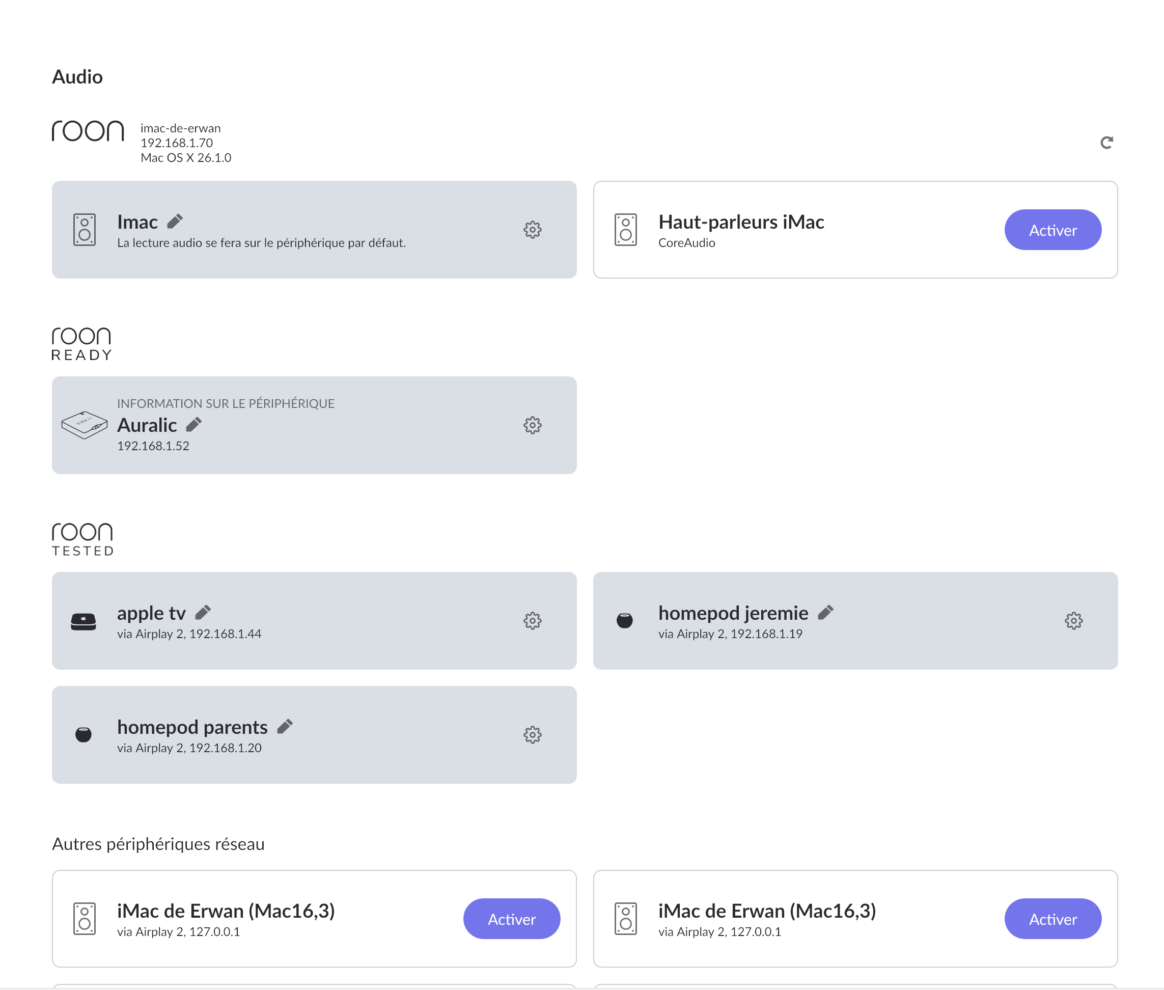

On my iMac, impossible to play music on my session either on the imac speakers or in bluetooth. it works in wifi, it works with my iPhone, with the other sessions of the iMac but not mine. the Roon server is on the iMac. The music plays on Roon when I click play but no sound comes out. No error message.
non problem with network, just iMac (recent).

From the diagnostics we’ve reviewed on your iMac, we’re seeing repeated network-layer failures at the exact moments when playback produces no sound:
01/01 09:28:39 Error: [discovery] error sending response: host is unreachable
This means that macOS is rejecting or blocking RAATServer’s network responses, even though the audio device is local. As a result, Roon believes playback is active, but the audio stream never reaches the output.

It seems to work. Thank you.
