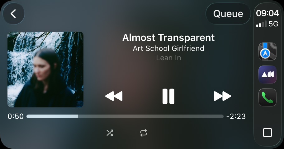

· Roon ARC on CarPlay with my Pioneer car stereo show that music is playing but no sound is coming through the speakers, this happens with both a wired and wireless connection from my iPhone 17Pro. This is an intermittent fault that has been going of for years.

On this particular occasion I had just dropped my children at school, ARC worked fine on the journey to school but when I got back in the car to drive home there was no sound, I had only stopped for less than a minute to walk my son to the gate. This was around 9:00 Australian Central Standard Time, Friday 31st.

Yes, ARC does still show the track time advancing, it definitely is not paused on either the Pioneer display or if you look at ARC on my iPhone.
