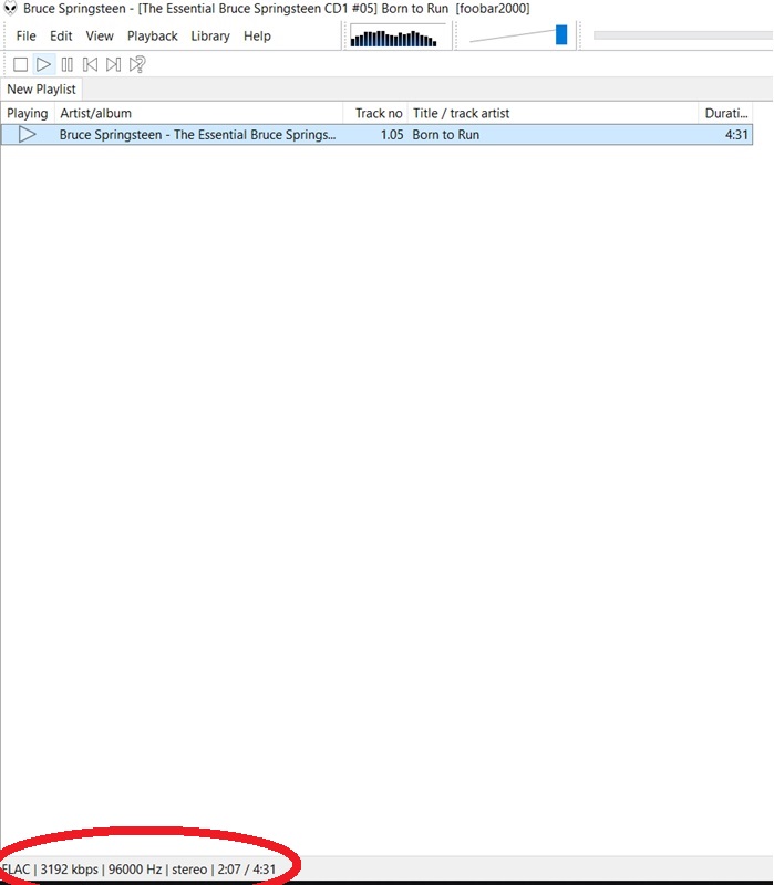

With Foobar in this case, were you using the WASAPI or ASIO driver? Was Foobar using Exclusive Mode? You would need to download the Foobar Exclusive Mode addon to ensure that the driver operates in Exclusive Mode, can you confirm you used this addon when performing your testing?

BB) Foobar2000 media player => run smoothly
CONCLUSIONS:
Using the Laptop (X240) as hardware for Roon Core and FOOBAR2000 playing all file rates include 23-96 and 24-192 smoothly w/o hesitating on C2000.
