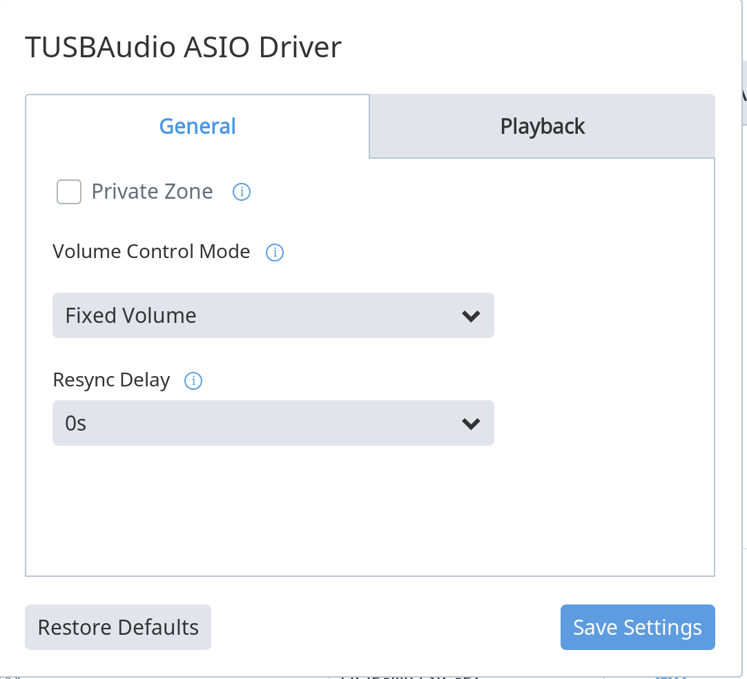

Here are screen grabs of my settings and playback screen.

Hi @Roberto_Milev ----- Thank you for the follow up and the feedback. Both are appreciated! Can you please confirm for me that the volume is at 100% in Roon while trying to stream DSD64 content from the app?
Hi, @Eric. As you can see above, I have volume control fixed. So I can not control the volume when playing PCM or DSD (see screen shot bellow). I know this was a problem with other users, but it does not fit the symptoms I am seeing.
Again, just like HDplayer and Jriver Roon starts to stream at 176khz - the Dac’s display shows “176”. However, in the case of HDplayer and Jriver the display switches to showing “64” (to indicate DSD64 stream) after about a second, and the music starts playing. In the case of Roon, this switch to “64” never happens and the display keeps showing “176”. Seems like Roon does not send the proper flag that the stream is DoP.
Hi @Roberto_Milev ----- Thank you for verifying that for me. If you set your “max sample rate”, “max bit per sample”, and “max DSD sample rate” to “disabled” do you notice any change in behavior?
