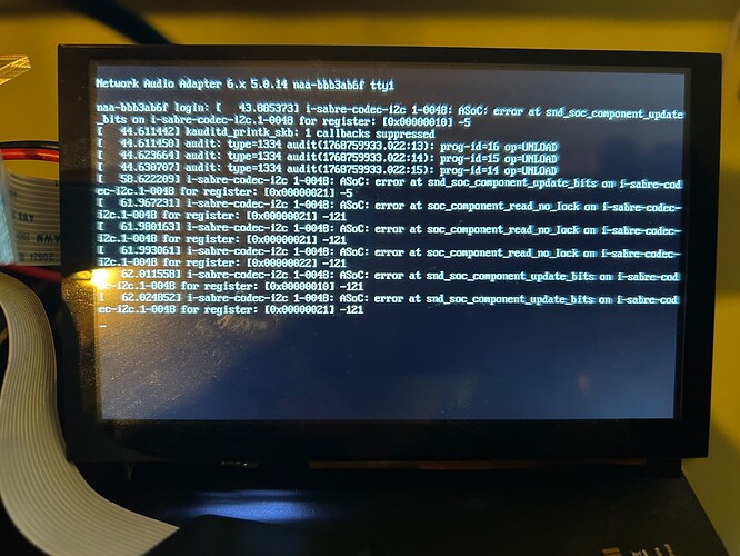

I downloaded the NAA-611-raspberrypi-holored.7z file, loaded it onto an SD card, and ran it on my Pi4 with an Ian Canada Transport Digi2. However, when I run HQP, I get no sound on my Holo Audio Cyan 2. My Pi is connected to a DAC with an i2S cable. I’m attaching photos of the configuration and errors from the Pi. I added the value dtoverlay=i-sabre-q2m to the config file because it wasn’t visible in the outputs. Can someone help me configure it so that the sound is audible?

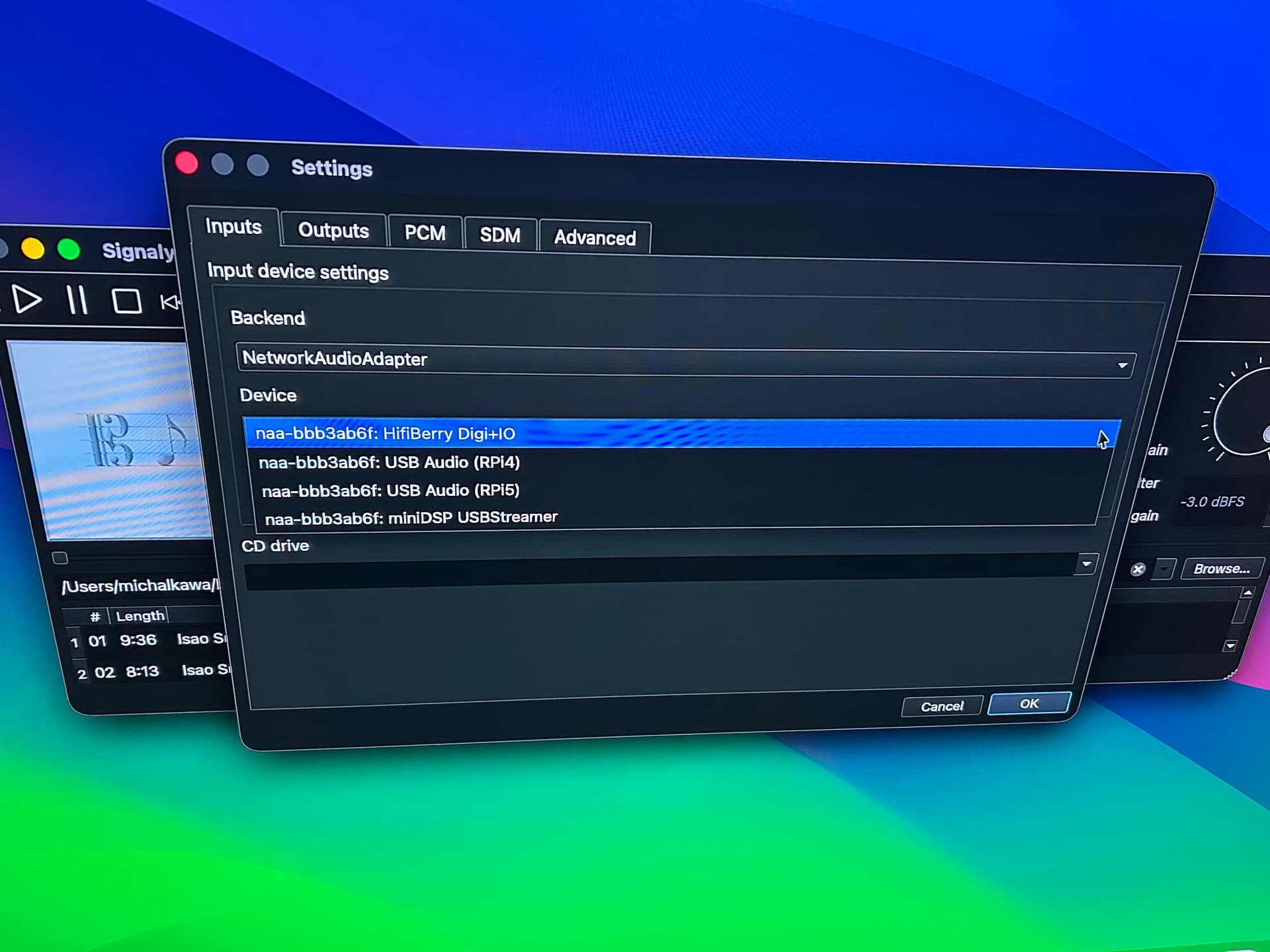

If you don’t actually use the input feature, I would recommend setting the backend to “[none]”.

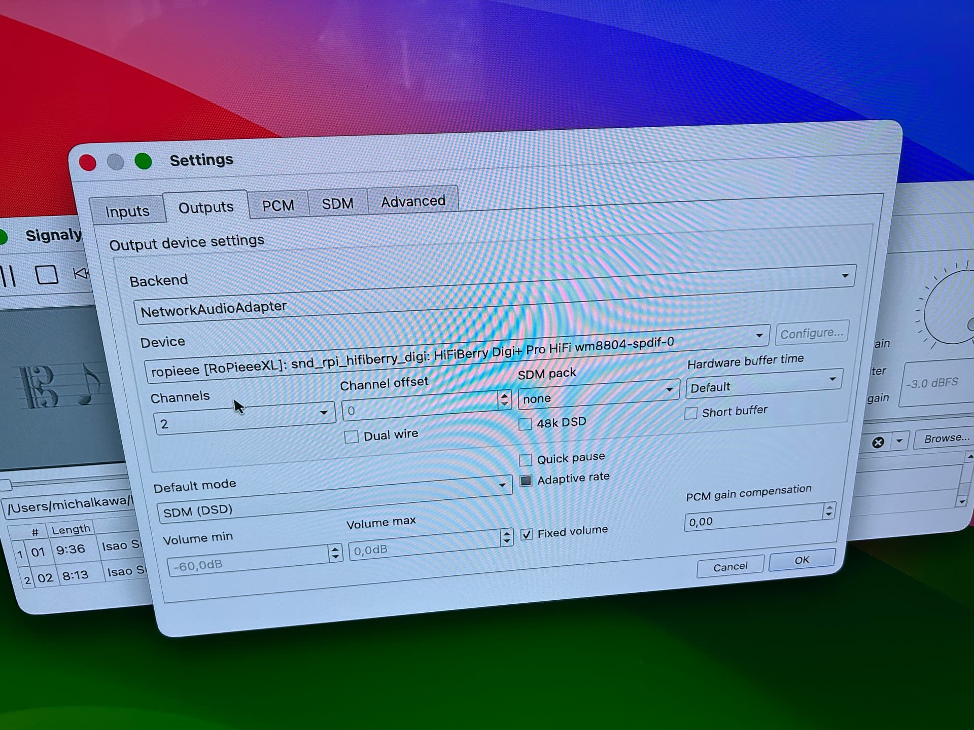

Can you also show what settings you have for the output side?
Do you actually have the hardware? Because based on the errors, RPi is having trouble communicating with the ESS Sabre DAC chip.

So in practice you are not using the input feature, so the input backend should be set to “[none]”. The input tab in settings is not relevant for you at this point.

I switched to RoPiee and set NAA from it. Now everything works fine because my card is correctly identified at the output. See the photo.
Now my question is, if in the config file of your NAA OS you would put such identification as in the picture, would the card be seen and play?

The Digi+ entry shown for input is a virtual device defined in NAA’s configuration file, it is not “detected”, it is a static definition there that is always shown.
