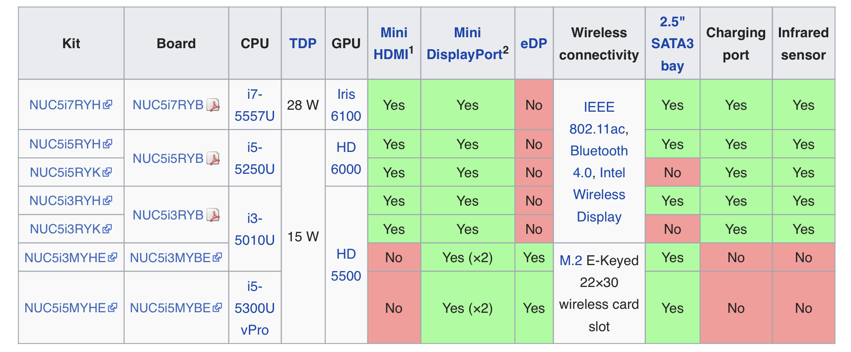

Please see the benchmark tests undertaken on a NUC5i3 here List Your NUC Capabilities Here
Basically a NUC5i3 does everything a later NUC6 or NUC7 does.
Most of the generational differences in the NUCs are
  1. Built in WiFi and Bluetooth - not required by ROCK
  2. Support for dual head 4K or even 8K displays - not required by ROCK
  3. Higher RAM support - for ROCK and 99% of music libraries 8GB is enough, there has been one case on this forum of a ROCK user needing more RAM.
  4. Faster SSD support - if a NUC5i3 with 8GB and a M.2 SATA SSD can do the same benchmarked workload as later versions, ROCK doesn’t need it.
  5. Higher CPU Boost speeds - again this is only when the CPU workload triggers the clock boost, which is only meant to be for short periods hence ‘Turbo Boost’, but the trade off is heat, which kicks the active cooling in, which as a fan makes noise - acoustic and electrical.
Either get the most basic NUC Xi3 available, with 8GB RAM and a SSD
or a secondhand NUC5i3/NUC6i3 and save some money.

You cannot boot ROCK from NUC5 NVMe SSD. If you choose to buy a 5th generation NUC, you will have to be careful to use a m.2 SATA SSD instead of NVMe SSD.

Technical data sheet for a NUC5i3MYBE
2.10GHz i3 CPU 14nm with 3M cache (virtually no difference in no of CPU pipes & clock speed used in a NUC to a 6th, 7th, 8th, 9th Gen CPU. It is only now Intel are releasing 10nm architectures)
Also from the same spec sheet, no WiFi or Bluetooth, which ROCK doesn’t need or use, so why pay for them?
Yes, but the M.2 SATA I/O can still operate at 500MB/s for Read & Writes
Not been proven whether ROCK needs anything faster from a more expensive NVMe SSD
