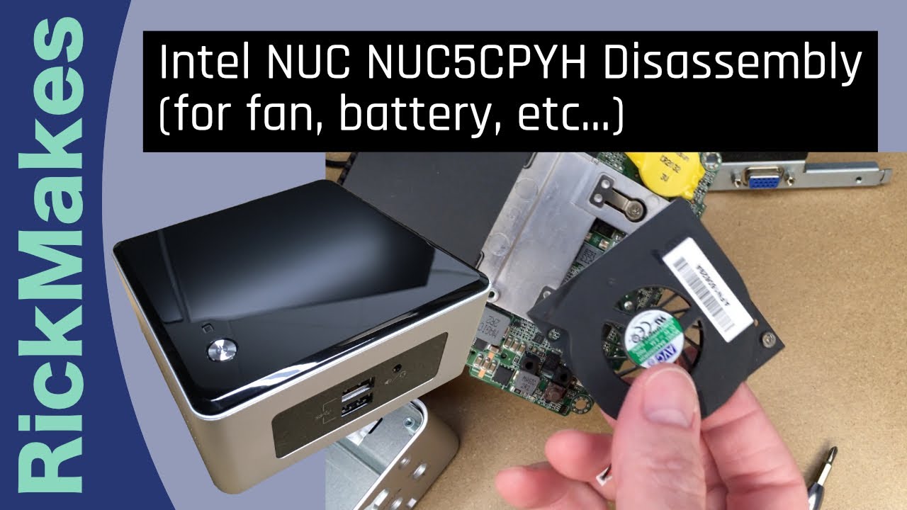

Hi @Nick ,
Do you see any lights on the NUC internals or do you prefer not to open the unit? If there are any lights on the motherboard, you can try a CMOS battery reset procedure, that has sometimes brought boards back to life, long shot but worth a try if technical. Instructions and video below:
https://www.intel.com/content/www/us/en/support/articles/000025368/processors.html
(Motherboard/CMOS shown at 5:55)

Thank you @noris. I will open it up and do the CMOS reset after work today. Also, appreciate the link you provided to supported NUC models.
The CMOS reset did the trick. My Roon Rock is back up and running!

Must say I have never had a computer fail to show any signs of life on a cmos issue but then stranger things have happened…will put this one in y things to try pigeon hole
There was a single green led on the motherboard that was lit, but I could not see it until I opened the case.
