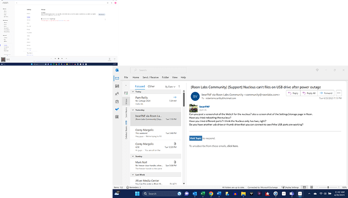

Can you post a screenshot of the WebUI for the nucleus? also a screen shot of the Settings/storage page in Roon.
Have you tried rebooting the nucleus?
Have you tried different ports? I think the Nucleus only has two, right?
Do you have another usb drive or thumb drive that you can connect to see if the USB ports are working?
Sorry but not sure what WebUI for the Nucleus would be. The Settings/Storage page is upper left of the attached image.
