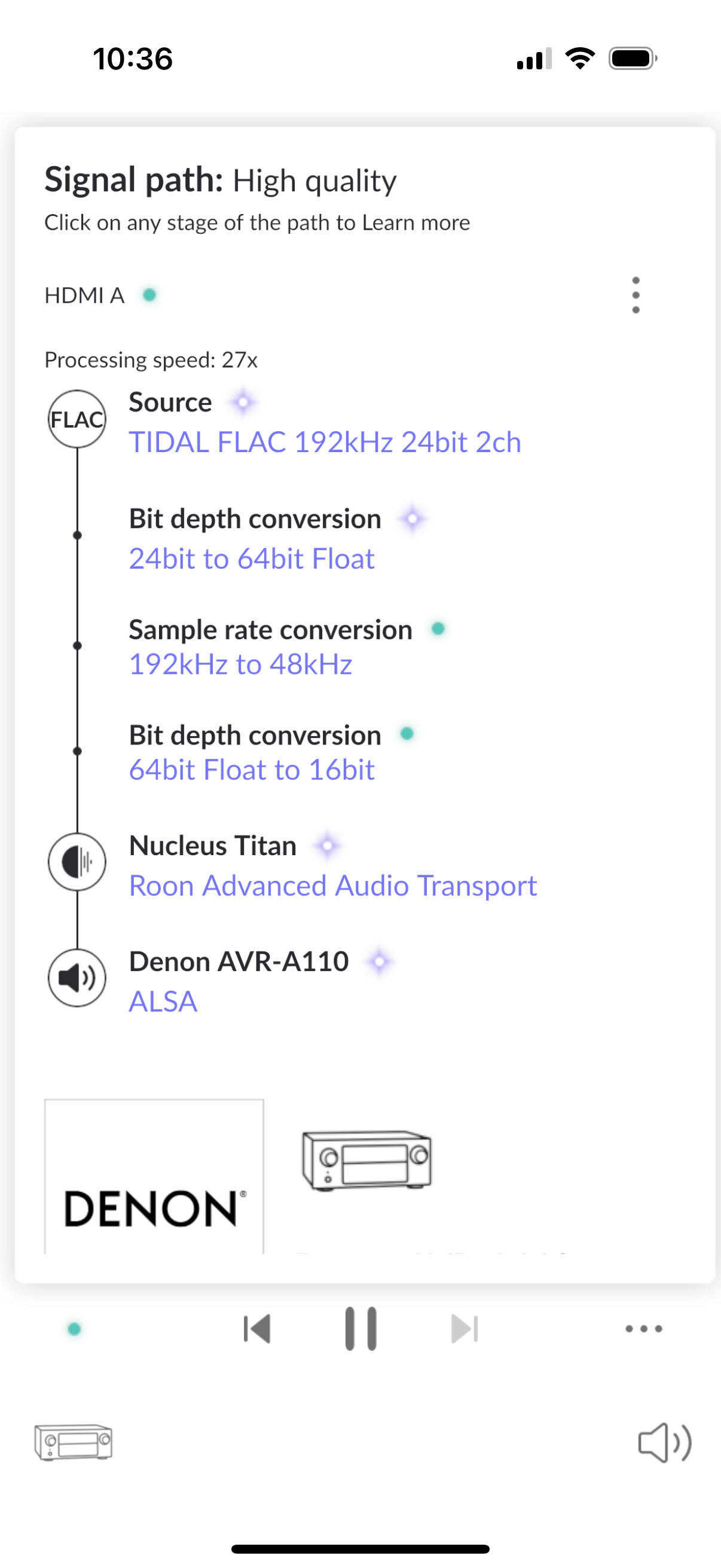

I am having a problem with my Nucleus Titan downsampling music intermittently using one of the HDMI ports but not the other but both are identified with the same output source. Please read on…
My Nucleus Titan is directly connected to my Denon AVR-110 via the HDMI A Output (as an example). I have correctly identified the output source of HDMI A and B both to be Denon AVR-A110 in Audio Setup.
Now, when I play a song using HDMI A, the track is downsampled incorrectly (see pic). I say “incorrectly” because if I switch to play the same track using HDMI B the track does not downsample (see pic).
If my solution was simply to use HDMI B instead as my output port then I would be a happy camper but this is only temporary. I don’t know the exact trigger but at some point HDMI B will begin to downsample the same track that it was not downsampling previously.
So at some point I try to test the HDMI A port again and it will no longer downsample so I then think ok let me switch back to HDMI A as my source output but this is only temporary as it will eventually start to downsample again with no other changes made to Roon and playing the same exact track (I’ve tested with multiple tracks of the same lossless quality).
Can anyone tell me what exactly is going on here? I know the Denon AVR-A110 is capable of playing 192khz at 24bit and I have demonstrated this is indeed occurring in the pictures attached so why does it start downsampling. Something is triggering Roon to downsample incorrectly. Fyi, The Denon AVR-A110 is a Roon Tested device.
Also, I have tried other music tracks with the same test and get the same intermittent downsampling issue. I have also tried to change the source output to some other model with a similar 32-bit DAC and get the same result. Though I don’t believe there is any 2-way communication between Roon and the source output for this to matter but I tried to is just to make sure the model within Roon isn’t specified correctly.

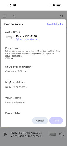

One interesting note, I can tell the downsampling will occur because in the HDMI setup on the Nucleus the PCM and MQA settings disappear. You can see this in the pics I have attached. So when I see “PCM” and “MQA” no downsampling occurs. But I have no known way of controlling when these settings appear in setup or not.
I am at a loss here. Can anyone help me figure this out?

Thanks for the reply. I’m glad someone else is seeing the same issue. My only disagreement on it being a handshake issue is that I can try HDMI B with no cable connected and it gets the same result meaning intermittent downsampling
So if we eliminate the cable being the issue which eliminates any communication or handshaking issues then it comes down to either the Nucleus hardware or a bug in Roon software.
Any thoughts on this?

Can you please try to perform a “Load Defaults” on the problematic zone and let us know if it helps?
Usually, you are able to also set a max sample rate for each zone in Device Setup, it is strange that you are not seeing this as an option. Another thing you can try is to un-identify the devices as Denon and leave them as generic HDMI outputs. Let us know if this helps.

I’ve discovered a very important piece to the puzzle. The Titan has two HDMI ports A and B. No matter which port you physically are connected to wherever the HDMI port is connected to this becomes HDMI A and the unconnected port is always HDMI B.
The more important discovery is that it is the connected port that is always doing the downsampling. The unconnected port is the port that plays to the original spec.

  4. I also confirmed that on HDMI A PCM and MQA settings are missing and HDMI B does have both settings available.
