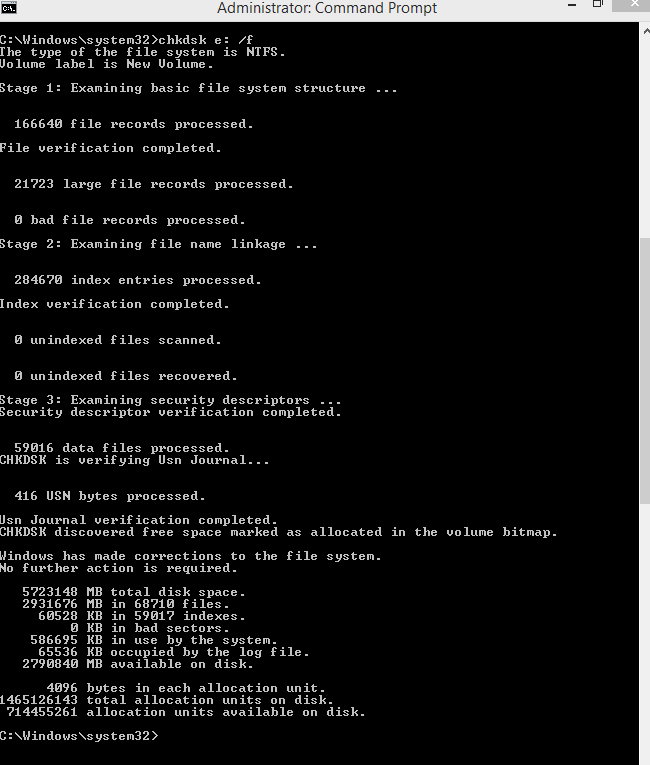

Thanks for the information. Let’s focus on the external drive, how is it formatted? NTFS or exFAT? If it’s NTFS, we’ve seen others find success in cloning their drive to exFAT.
With that, let’s look into investigating the drive in more depth. Are you able to run chkdsk /f from the Command Prompt to check for any disk failures? Here is a breakdown on how to do this : How to Use CHKDSK to Scan & Fix Windows Hard Drive | Avast.

Hi Ben
Thanks for the advice. Here it is:
It’s NTFS with no disk errors.
Subsequently I formatted a portable hard drive exFAT and transferred some files to it. I connected it to the Nucleus+ and it showed up. I was able to add it’s location and play the files.
