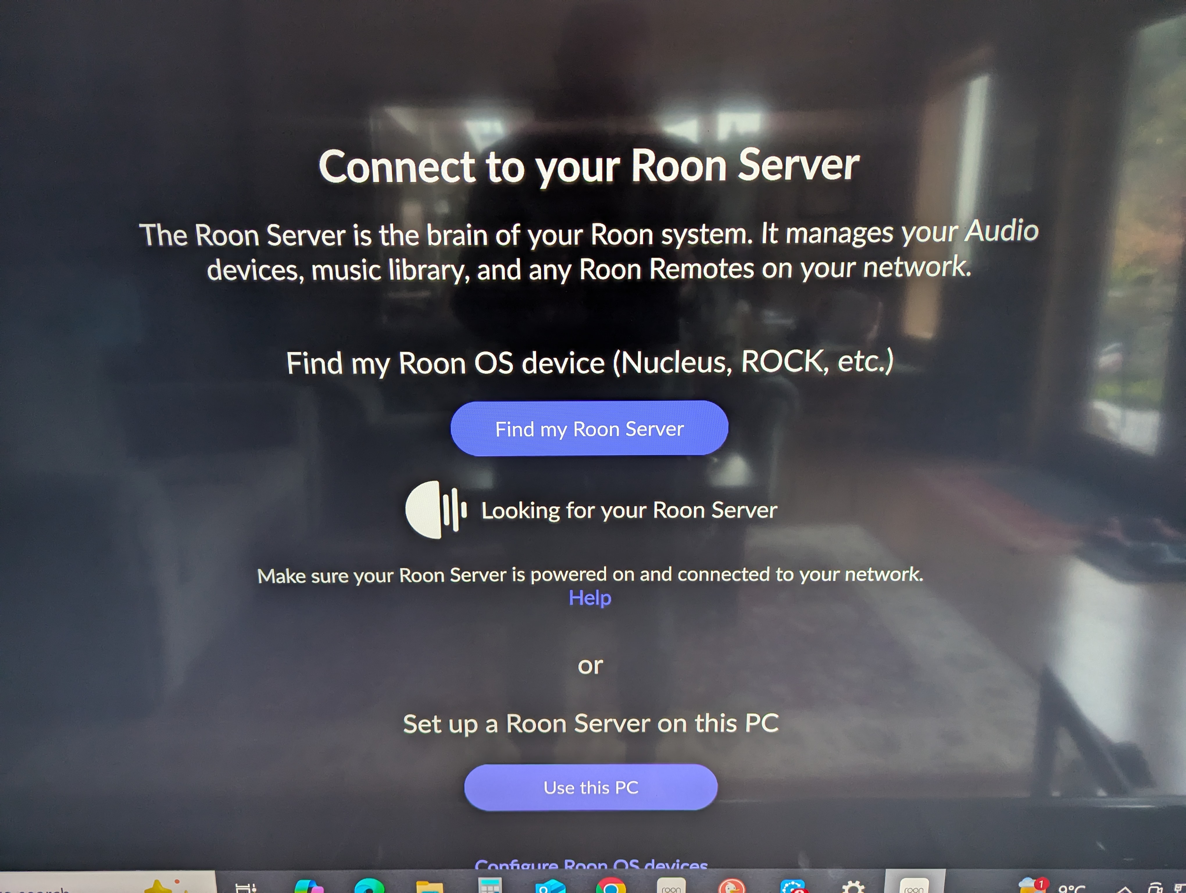

This has happened before, if the Nucleus loses power, the entire system fails, it was working after over 2 weeks of trying to get it back online and then a power failure and it has been weeks and I can't get it up and running.
Fing recognises the NP as in the network along with my PC that was the original server before the NP and now it defaults to the PC, the power light was working this morning and now it no longer illuminates, the lights of the ethernet connection come on for a period of time and then off for a period of time.
When I connect an HDMI cable to the NP and then my monitor, nothing appears on the screen.
With fing, I can see that the NP, the devialet amps and the PC all have different IP addresses. 192.168.1.70 192.168.1.71 and 192.168.1.72 The NP appears to be there, but nothing will recognize it as there, except fing. I tried looking at the router details but could not find the NP or devialet amps listed. It had been suggested the the motherboard died, but after that diagnosis it came back to life until a power interruption,
this is hard wired all the way from the modem, fiber optic at 300mbps to a dlink splitter that has been in place since day one, it runs the amps, PC and NP all hardwired and checked out with a meter. A telus wifi hub modem/router
