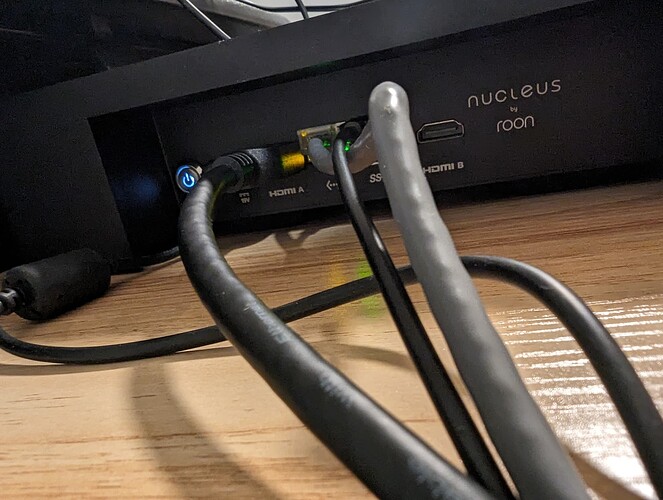

Purchased a used Nucleus + and plugged my Ethernet cable in. Pulled up the Roon app on my Pixel 7 Pro and the Nucleus could not be discovered.

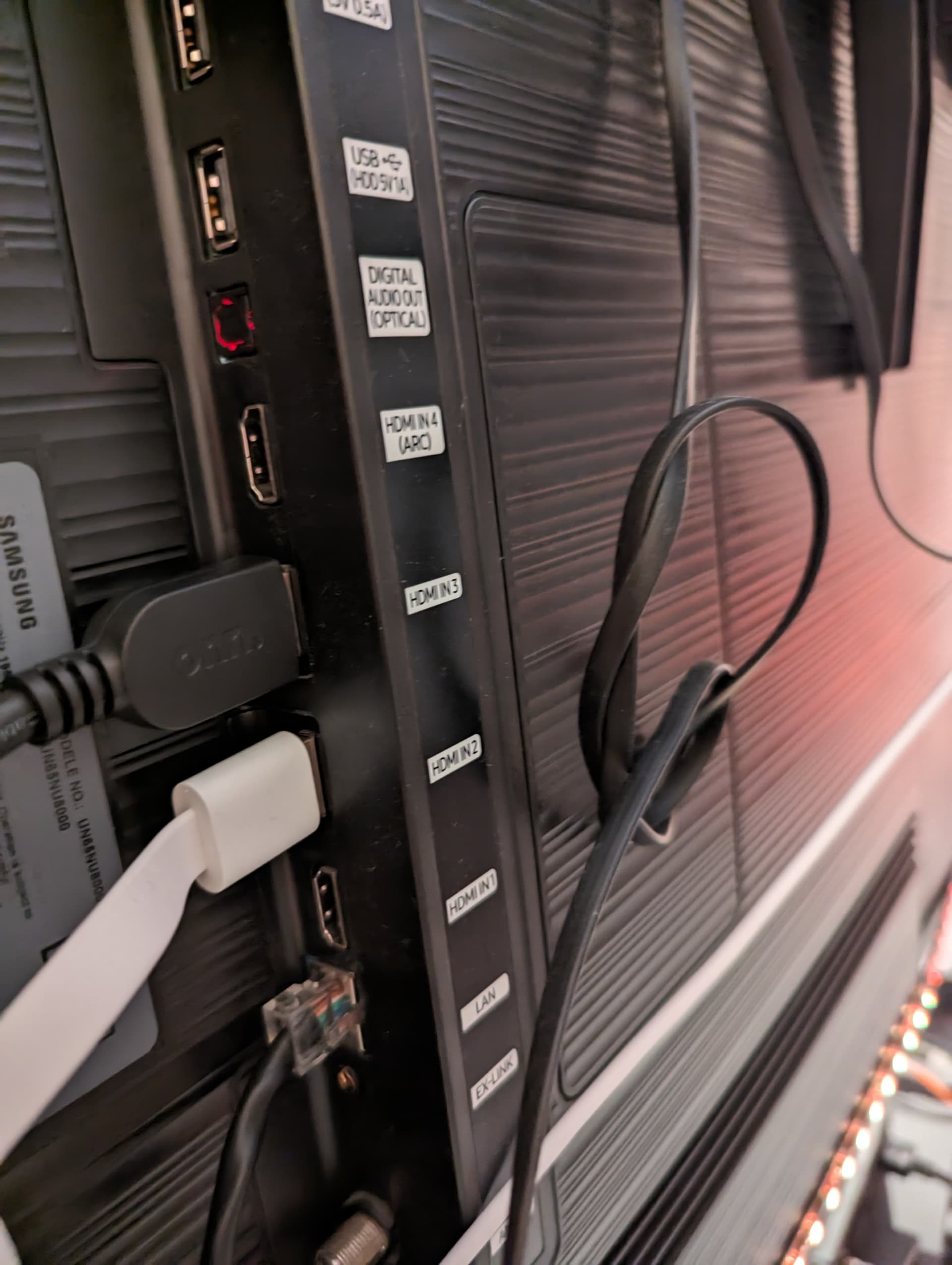

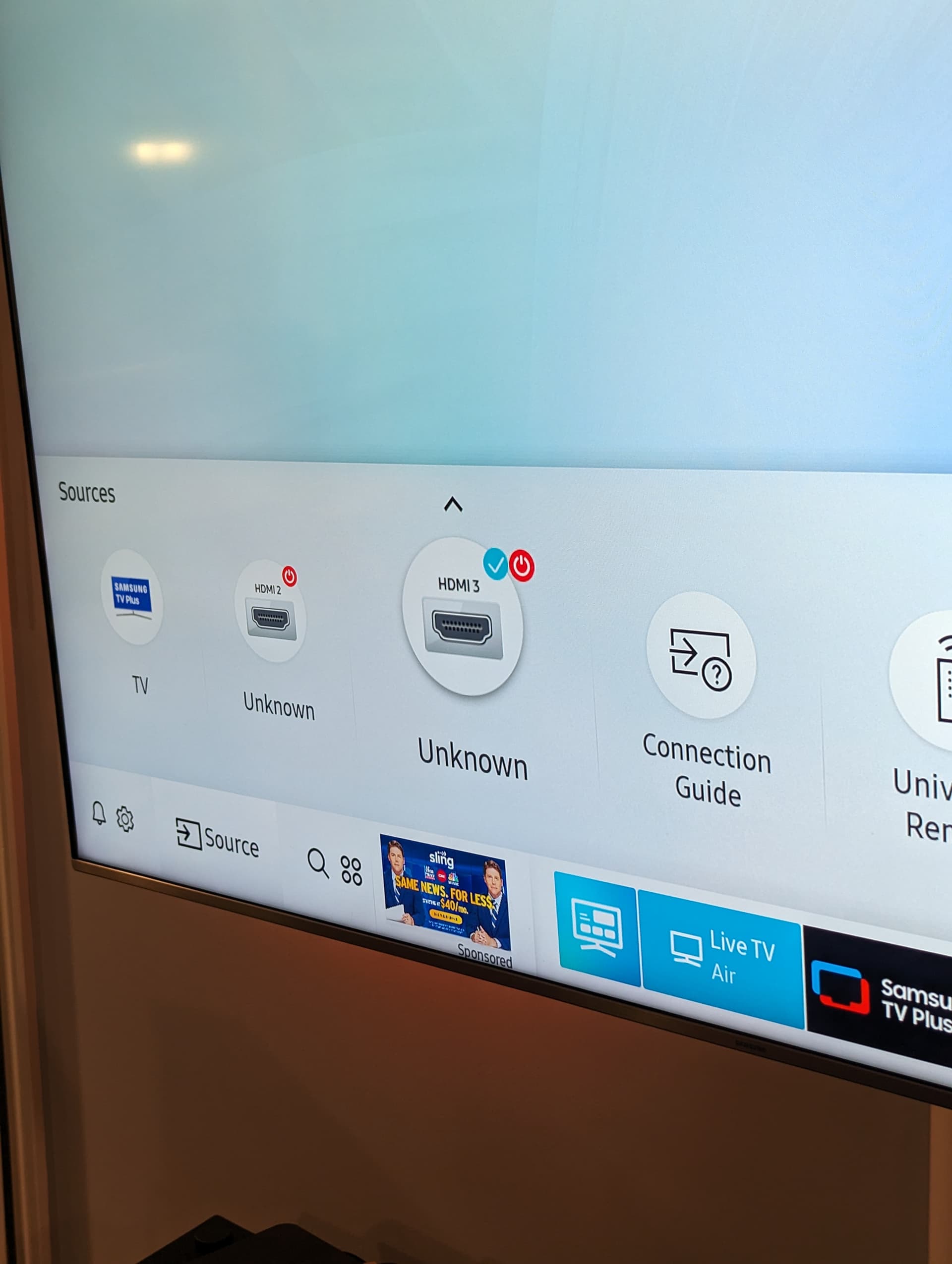

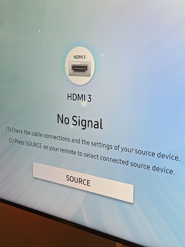

I try hooking up a USB keyboard and HDMI out to both my TV and a monitor. No signal on either screens and no light on the USB keyboard.
Any assistance would be appreciated.

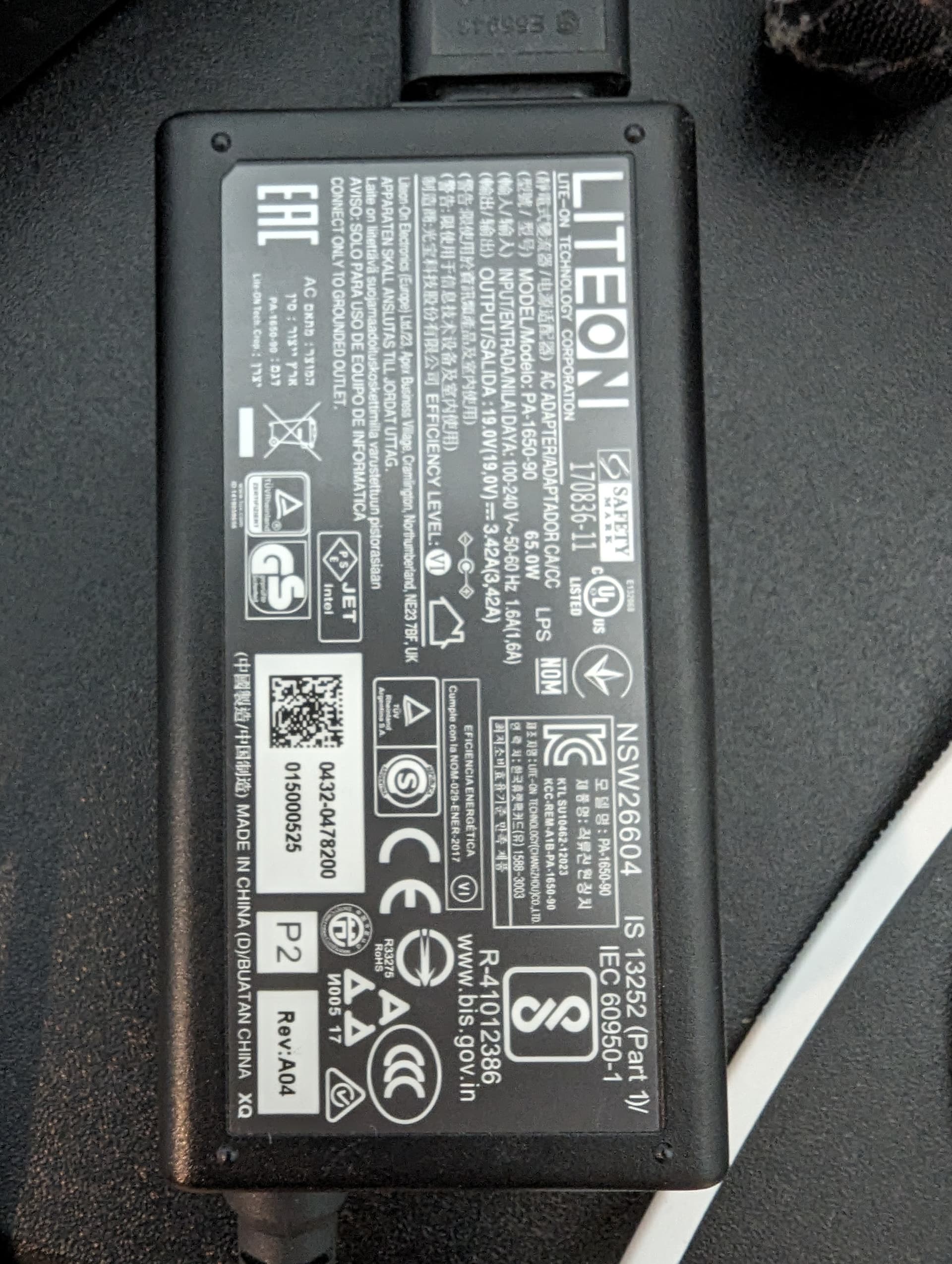

Post a picture of the power supply which accompanied the Nucleus+, please? (Preferably with the specs visible)

I purchased this on US Audio Mart, seller advised it was purchased new last September. I’ve attached the photos for your reference.

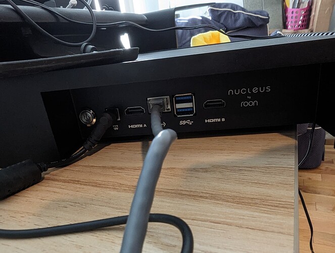

I am not seeing a light on the Ethernet port, are you sure the Nucleus Plus is turned on and operating? Also did the seller reset it so you can use it on your account?
I had it turned off when taking the picture. I can confirm there is power and Ethernet connectivity. I’ve reached out to the seller but in the meantime I tried Roon’s instructions to reset the network settings with no luck.
Well, it seems it is running in some way.

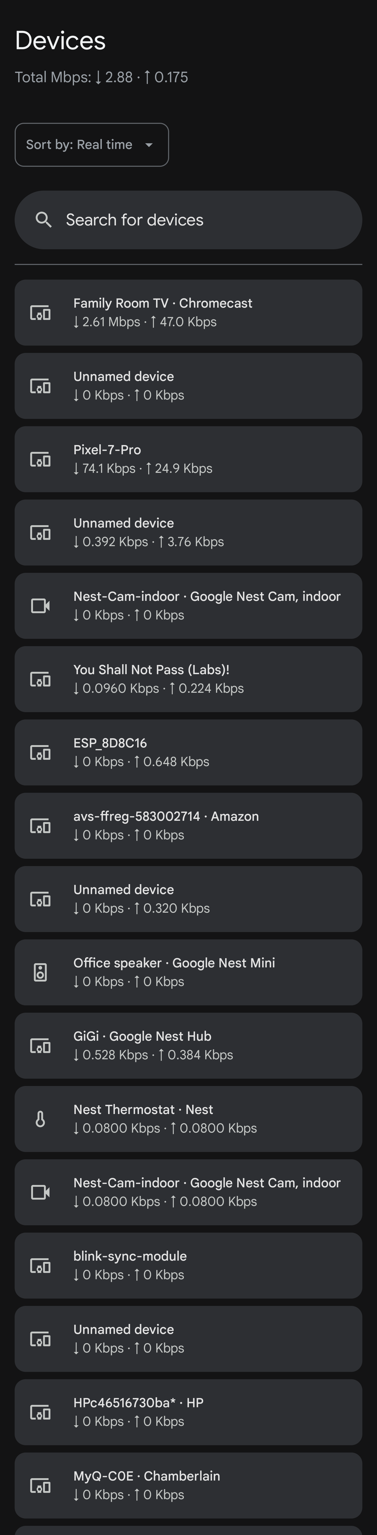

You have a few “unnamed devices” in your client list, do you know what these are? And please give the HDMI-connection a new try, see if you can get any screen going, that’s really the best way to identify whats happening.
Worst case:
Error report, indication of hardware issues.
Best case:
A screen saying it’s retrieved an address, and which one…

The unnamed devices are listed as wireless in the details . I tried both HDMI ports and was unable to get a signal out to my TV.

Have you tried a different cable also? HDMI cables are (ime) unreliable, at best. I usually use a computer screen for this, but your TV should be fine of course.

I tried re-seating the internal memory SSD again, used 2 different HDMI cables, but no luck. I am still not able to get visual.
