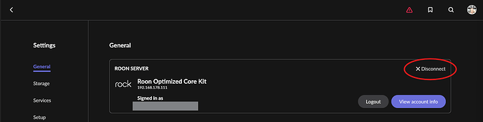

What are you actually doing? Disconnecting or logging out of Roon? On this screen you should be clicking the X Disconnect link, not the Logout button…

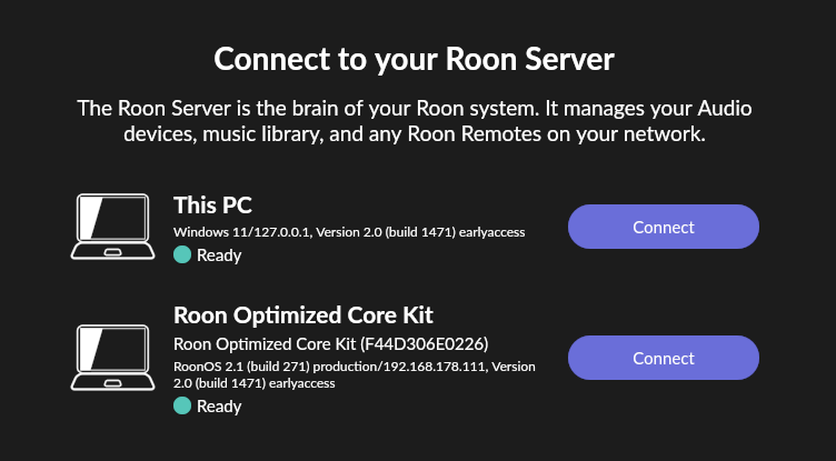

When you do that, you should be seeing all the running Roon Servers in your network, something like this:
Just connect to your Nucleus One, which should be showing…

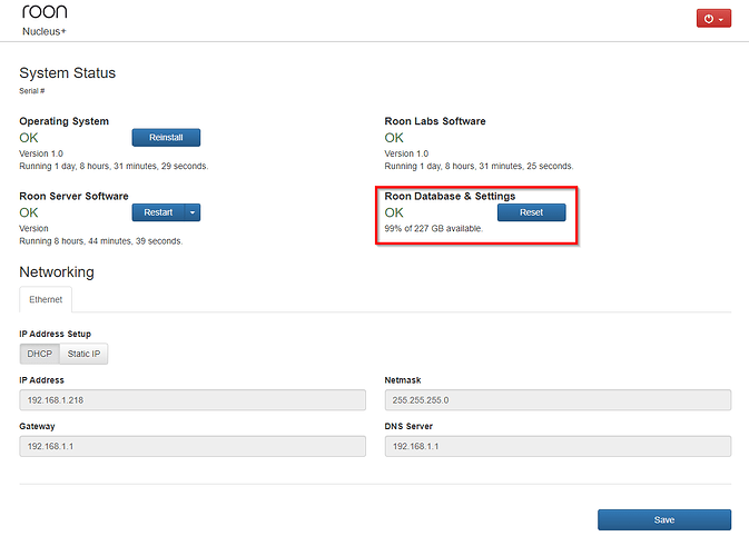

Please confirm the disconnect / log back on clarification that @Geoff_Coupe requested when you have a chance. Also, I am not noticing your Nucleus as being active recently, and no audio zones showing up is sometimes a symptom of database corruption. Are you still able to access the Nucleus WebUI properly?
It would be ideal if you could access your Nucleus Logs using these instructions and upload a set to our Log Uploader , but if you are not able to access the logs, then I would suggest trying a factory reset on the Nucleus database:

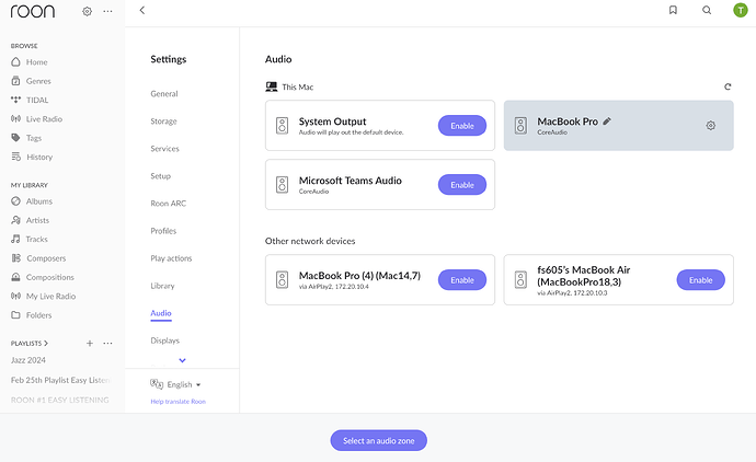

Can you post a screenshot of Roon’s :gear: > Audio screen? That would show us what audio devices are available to you to be set up in Roon. This help article gives information on setting up audio devices and creating playback Zones:

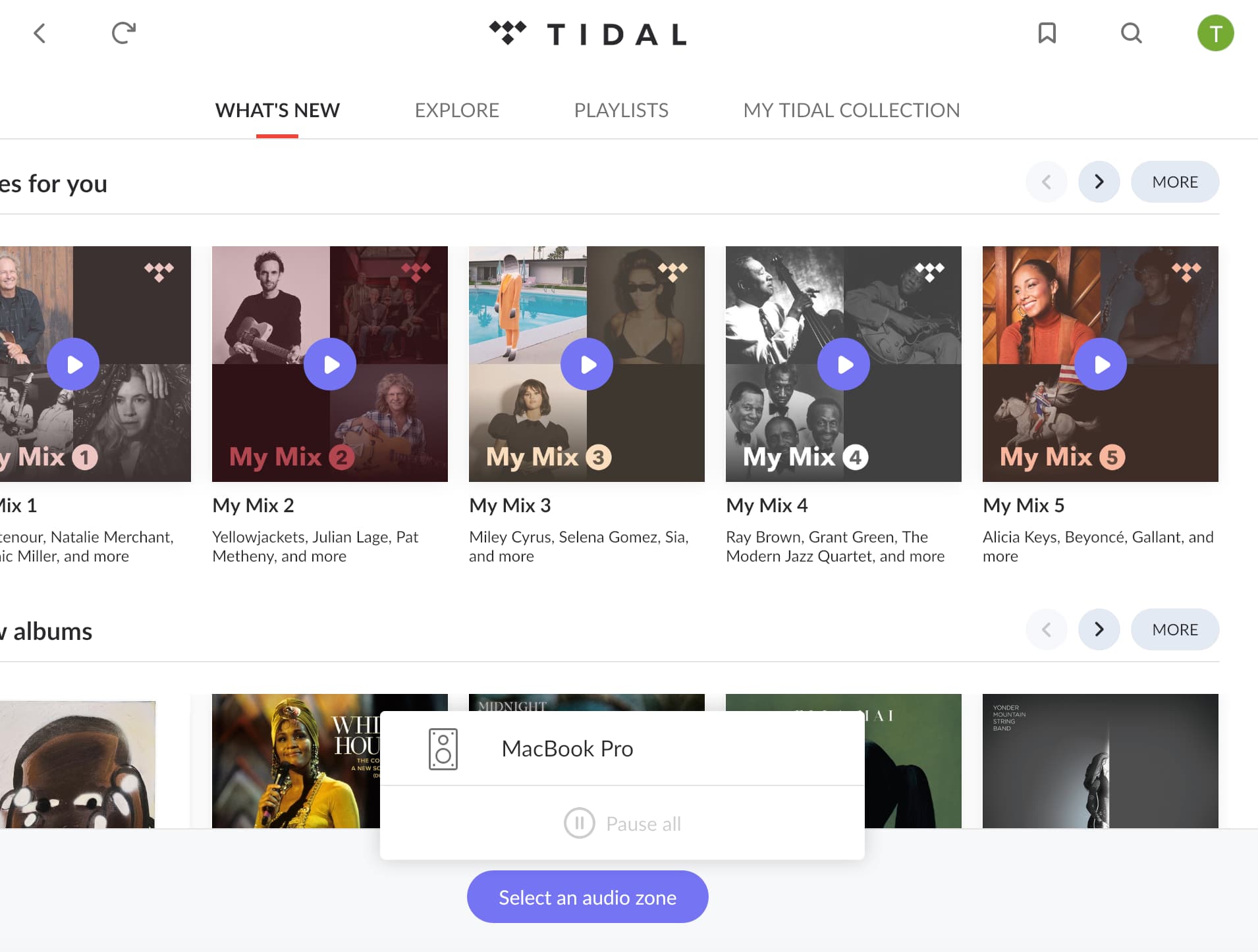

Hi Benjamin and Geoff. Unfortunately I still cannot use the nucleus. If I am able to connect there are no audio zones available. Only HDMI which I don’t have connected. If I disconnect from the nucleus and return to the core installed on my Mac I can use Roon as in the past. To be honest I would prefer to pay a tech to get the Nucleus up and running so I can start to use it. I am frustrated at having to navigate through the recommendations for hours on end to no avail. Can we do a screen sharing session and start to enjoy this new Roon Device? Thank you
I don’t think the issue lies in the Nucleus. What I think you are saying is that when you use Roon connected to the Roon Server in the Nucleus, then Roon’s :gear: > Audio screen only shows the HDMI audio device of the Nucleus, and does not display any other audio devices on other devices in your network. As I asked earlier, a screenshot of this screen would confirm this. I think there is a possible network issue at play here.

I agree with @Geoff_Coupe that a screenshot of your audio settings would make things more clear. This certainly sounds network related to me.

I am not able to give you a screen shot of the audio settings any more. When I open the Roon App, the nucleus is no longer found as a server. I tried 5 times and no luck. On one occasion, I saw that Nucleus had been found and there was a connecting light on it, but it dissapeared and did not connect. I can access Roon through my iPad now which is the Core in my MacBook Pro. When I open this, and look for available audio zones, I have only what you can see on the screen shot (no audio system available)

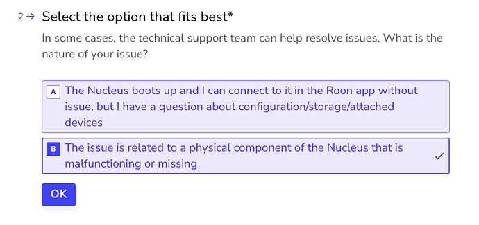

Hi @Tony_Melles,
Thanks for the report, and I’m sorry to hear you’ve hit some hardware issues with your Nucleus. The best next step here is to get in touch with our RMA department directly, as they’re in charge of all hardware-related Nucleus issues. To do so, open the Typeform link below and select ‘Other’ followed by 'This issue is related to a physical component".
Typeform link : Nucleus Troubleshooting
Screenshot for reference:
They’ll help get you sorted out moving forward. Thanks! :+1:
