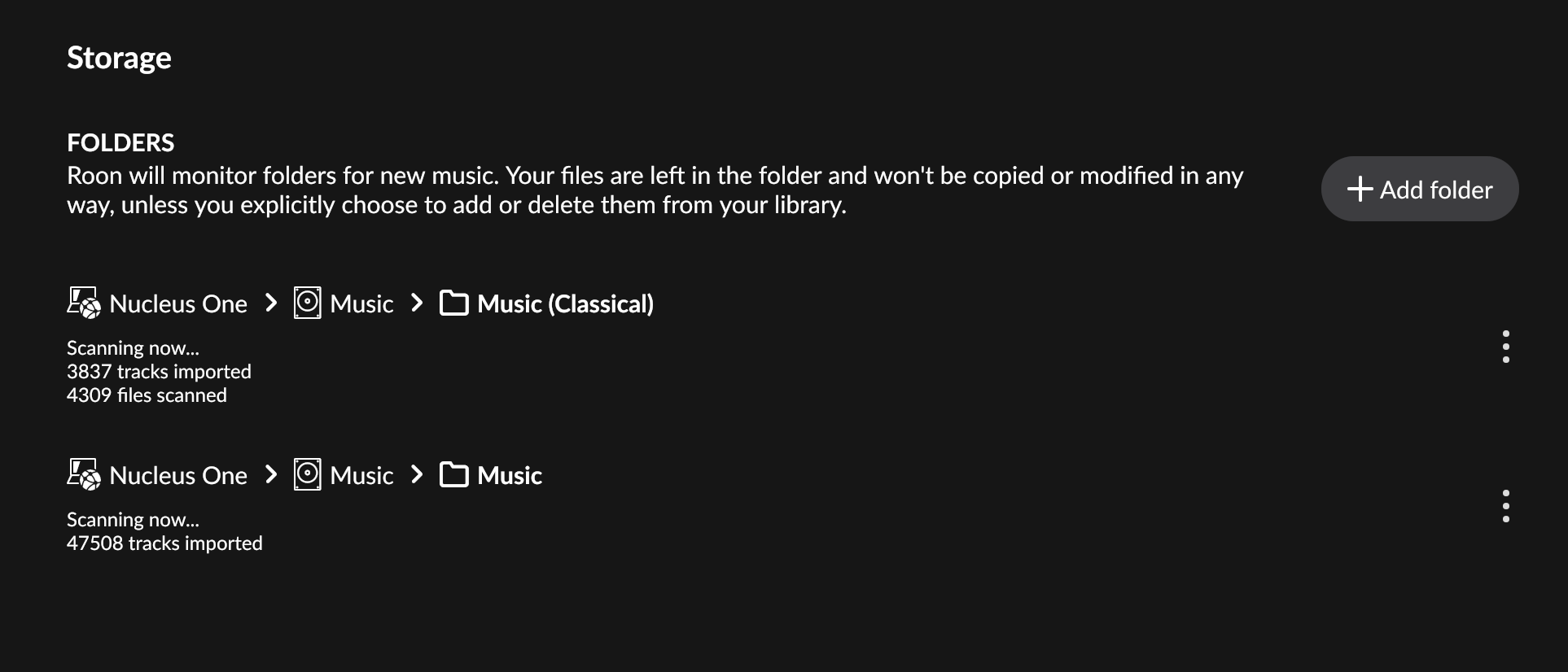

Can you please access the webUI of your Nucleus and share a screenshot? Here’s more info:
With that, can you also share a screenshot of your Roon Settings>Storage

When i reset the database, i tested using a fresh database, and still using it now. It behaves the same as the old restored database, crashes and reboots all the time, even when only browsing through my albums, without playinig anything.
My Nucleus is connected directly to my Ubiquiti Dream Machine Router all the time. I am 100% sure that the crashing and rebooting is not a LAN network related issue.
When i browse the album section, at one point it cannot load all the thumbnails, and then the connection with nucleus stops with “Uh oh, something’s not right” message, and then the connection returns after waiting for a while (few minutes).

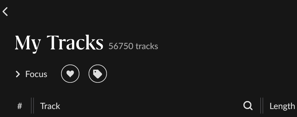

What is the total number of tracks tied to your library?
Hello Benjamin,
I have approx 57.000 tracks. But that is my original restored library.
The Logs i uploaded were from the clean library (for testing, as you suggested) with only qobuz and Tidal connected, and it had only aroud 400 albums). This “out of memory” issue is from the logs i uploaded? It seems strange.
