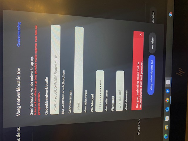

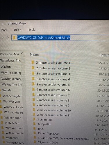

I have a nucleus one. I can get my WDMYCLOUD library in Roon. I've tried it with my windows pc, Mac pc and Iphone. I can entry my Nas with all pc's and and checked my path. It works perfect with sonos and Bluesound. There the libary is added perfectly. Roon says Could not connect to networkshare , host not found. My JRiver on windows 10 pc works also fine. The WD nas is visable in my Deco mesh network and all have a fixed ip. I used before the Nuc One a Mrock and a Macbook as a roon core and there was no problem at all. I've tried everything ( Also SMb 1 etc..) Help....
Mesh network X50 tplink/deco , WDMYCLOUD 4 tb ,Nucleus one. All Wired with fixed ip

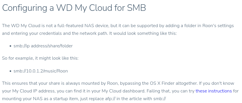

Try and use the IP-Address:

Doesn’t work , tried already. Gives than “unexpected Error” . I’m out of options. I’ve had no issue at all with a Mrock rooncore or with my macbook as rooncore. Al other systems ( Jriver,Sonos and Bluesound) have no problems with the same network path

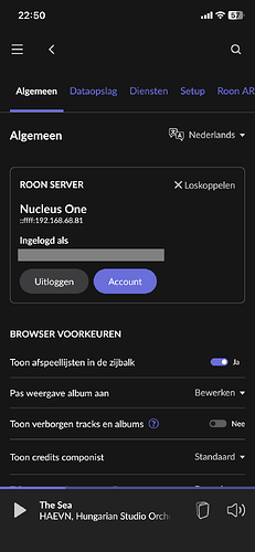

I’m curious - since we’re not seeing your Nucleus tied to your account, and it seems like you may not have access to Nucleus logs, how is the machine connected to your router?
Can you please set up a direct ethernet connetion from your Nucleus to your primary router, bypassing all network gear?

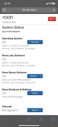

With that, can you also attempt to access the webUI of your Nucleus? Here’s more info:

Its directly connected to the router. The nucleus one works with tidal in my network. So its there.
When i put in the ip adres in my browser i’m in nuclues menu
