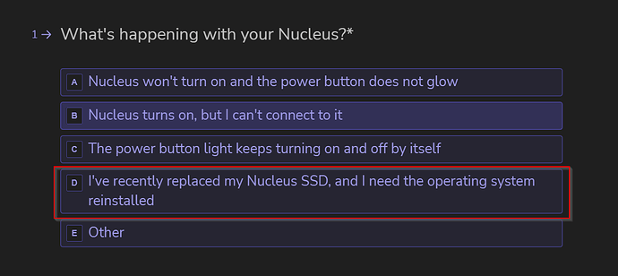

Hi @Graeme_Newell ,
Thanks for reaching out, I agree that this is most likely a failing SSD. Once you have ROCK up and running you can fill out the below form and that will get you to the right queue for review:
https://account.roon.app/en/contact/nucleus-troubleshooting/
