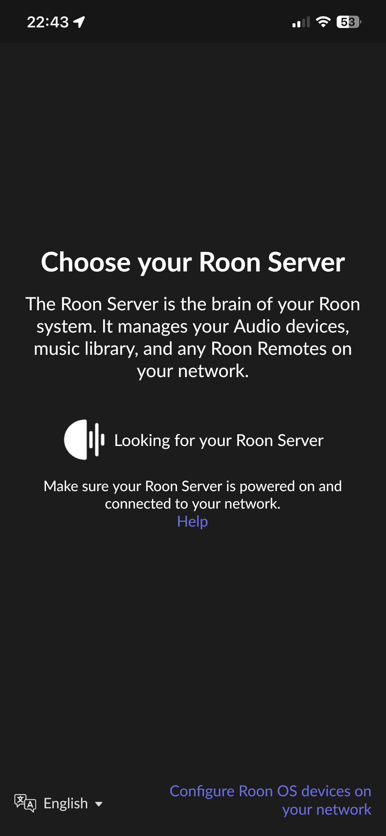

Nucleus Plus (Serial 54B203939A68) will not connect to network. Remote indicates looking for your Roon server. Tried power reboot. Changed network switch inputs. changed network cable.
Spectrum Internet modem to Luxul router to Pakedge switch. 8TB SSD installed. No other network connection issues throughout home.

all audio gear is on same switch without connection issues. I’ve also swapped inputs with no change to result.
