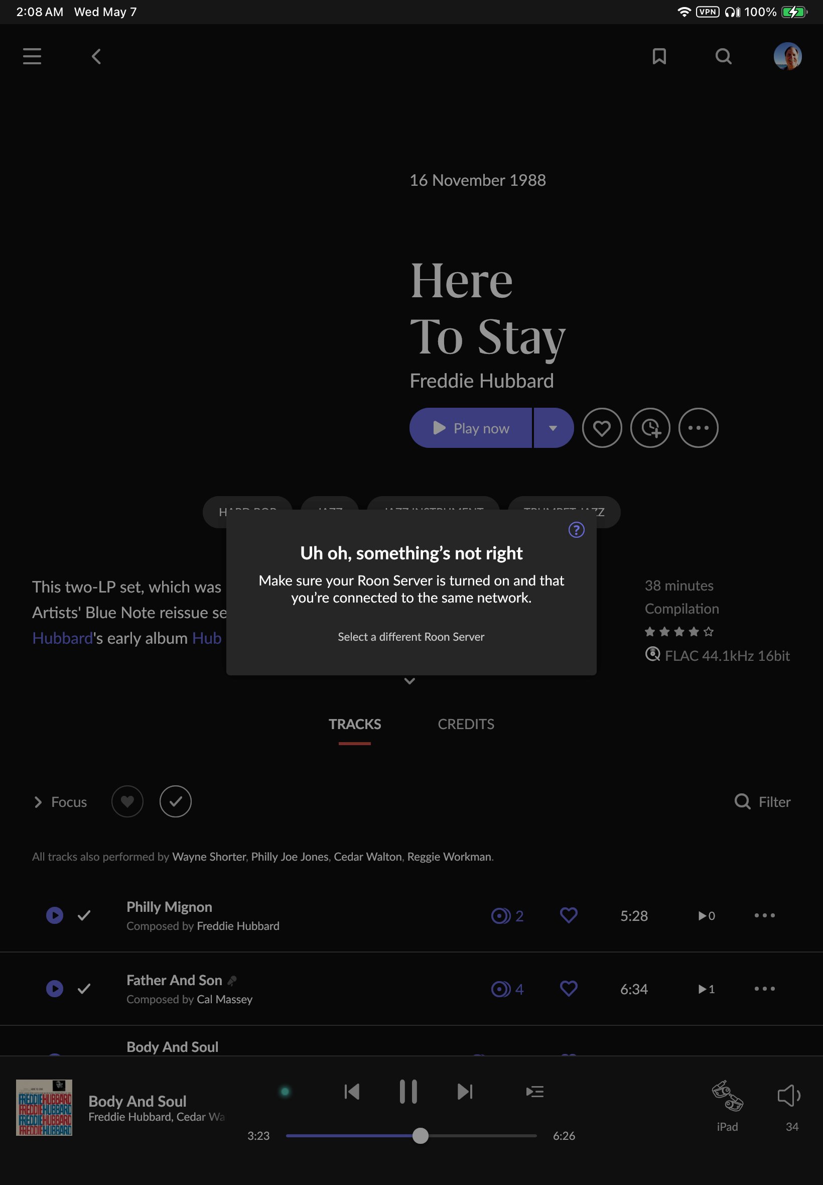

Randomly, the Nucleus server will disconnect and cannot be found by the Roon client software. The only solution I have found is to reboot the Nucleus server. This has been happening quite often since I got the Nucleus.
ASUS router, AT&T fiber gateway.

I notice you’re using a VPN and using the iPad as the endpoint for playback.
Assuming you’re on the same network as the Nucleus, what happens if you disable the VPN?
If you’re not on the same network and are using the VPN to access your home network from another, it might be work considering Roon Arc (either via port forwarding or the Tailscale VPN integrated with Roon OS).
Thanks for the quick response. I have posted about this problem a couple of times before and I never have had a response. I am connected to Roon on the same network as the Roon server. Also, I have noticed that when Roon disconnects from this endpoint, it is also disconnected on other devices such as ny iPhone and computer. I think my Nucleus One server is a lemon. I never had this issue with my previous NUC setup.
I will disable the VPN, but it won’t prove the server is working properly, because it is an intermittent problem.
