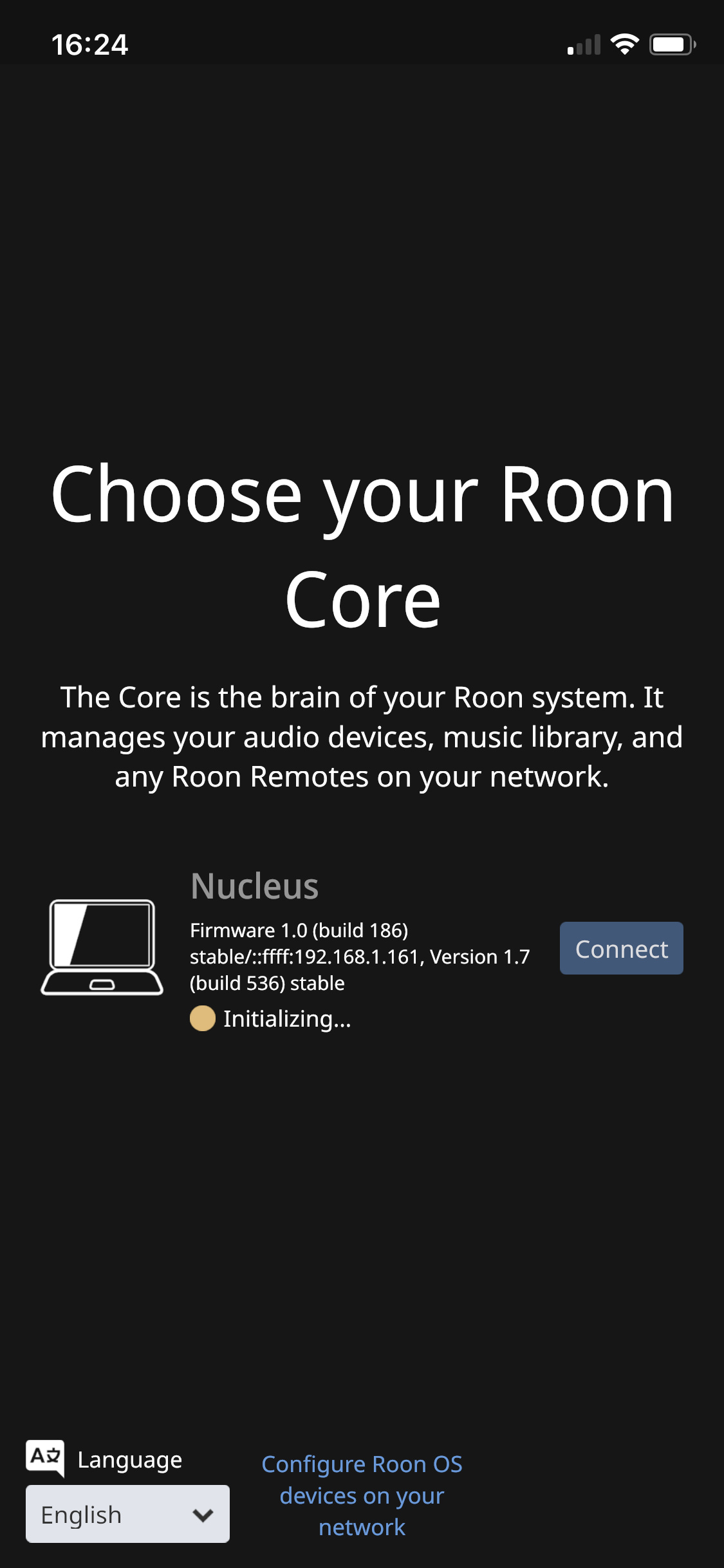

I’m setting up a brand new Nucleus that I bought today for the first time, and it looks like I’m still having the initializing issue that others are having/have had. I was prompted to update the firmware, but it’s been initializing for over an hour. I’ve tried rebooting, reinstalling and starting remote apps again, without any success.

Thanks Dylan, I’ve tried an iPhone X, iMac Pro and MacBook Pro remote device, but its the same on all of them. The iPhone screen shot is below:![IMG_4382|230x500]
