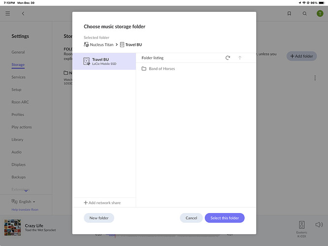

The Roon Server of the Titan will only recognise internal storage automatically; you must add Watched Folders on external usb-connected drives manually.
Can you post a screenshot of the “Choose music storage folder” screen that you get when you go to :gear: > Storage and click the “+ Add folder” button?

It appears to be here:
Exactly - so in the example you show, you would click on the Band of Horses folder then the “Select this folder” button to add it as a Watched folder.
However, you wanted to copy files and folders from these drives to your Titan, which you have done using an alternative method, so the above is just to demonstrate how you can access data on USB drives connected to your Titan within Roon.
