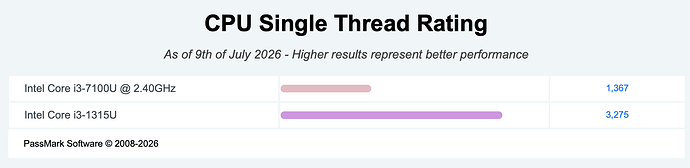

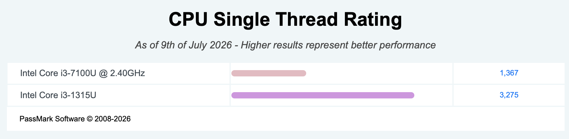

So based on the single core speed alone (which is the most important thing for Roon), it is a lot faster:
However, whether it is fast enough depends on your library. How many tracks (local and streaming) are in your library?

I’d been debating the same thing regarding updating from Nucleus Rev B to Titan. I finally bit the bullet and just yesterday did the swap. About 7500 albums/110K tracks split pretty much 50/50 between internal storage (I swapped the drive over from Nucleus to Titan) and Qobuz. The difference so far is staggering. Much snappier all around - loading Artists, Albums, Searches, etc. Caught the July 4th sale on the Titan plus did the trade-in for the old one, so saved some money too. Very happy with having finally made the move - my $.02. Good luck.
