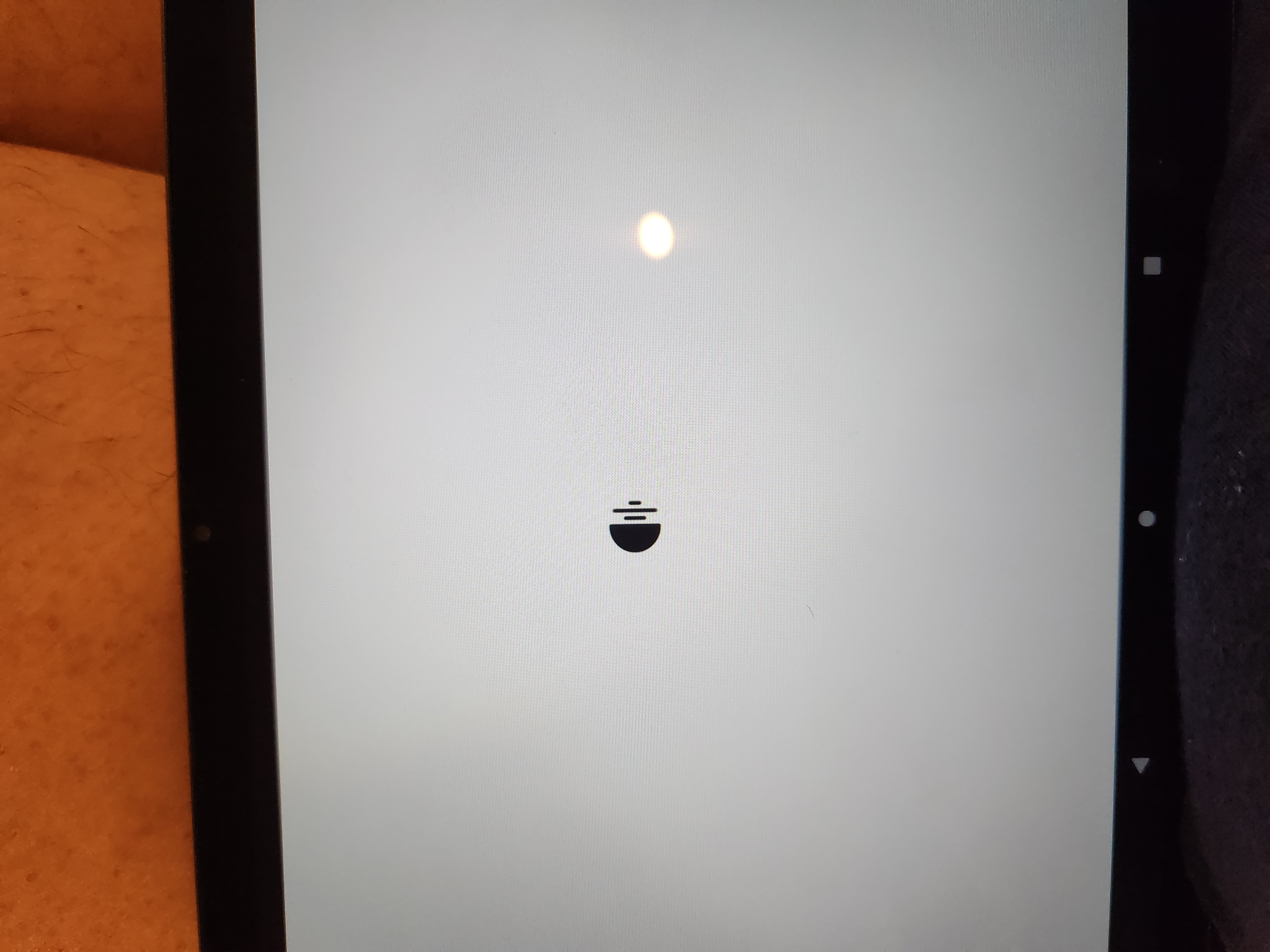

When you try to connect, what screen do you see?
· Just the Roon logo
Please try to restart your Roon Server by closing the Roon app in the taskbar or rebooting your Roon Server machine.
· *Roon Optimized Core Kit* (ROCK)
I see my Nucleus+ on my phone or tablet saying it is ready to connect. When I press Connect, the Roon logo appears and pulses, but it never connects to my endpoint from CH Precision. The network has been rebooted and nothing else has changed. This just started recently. I'm at a loss.
