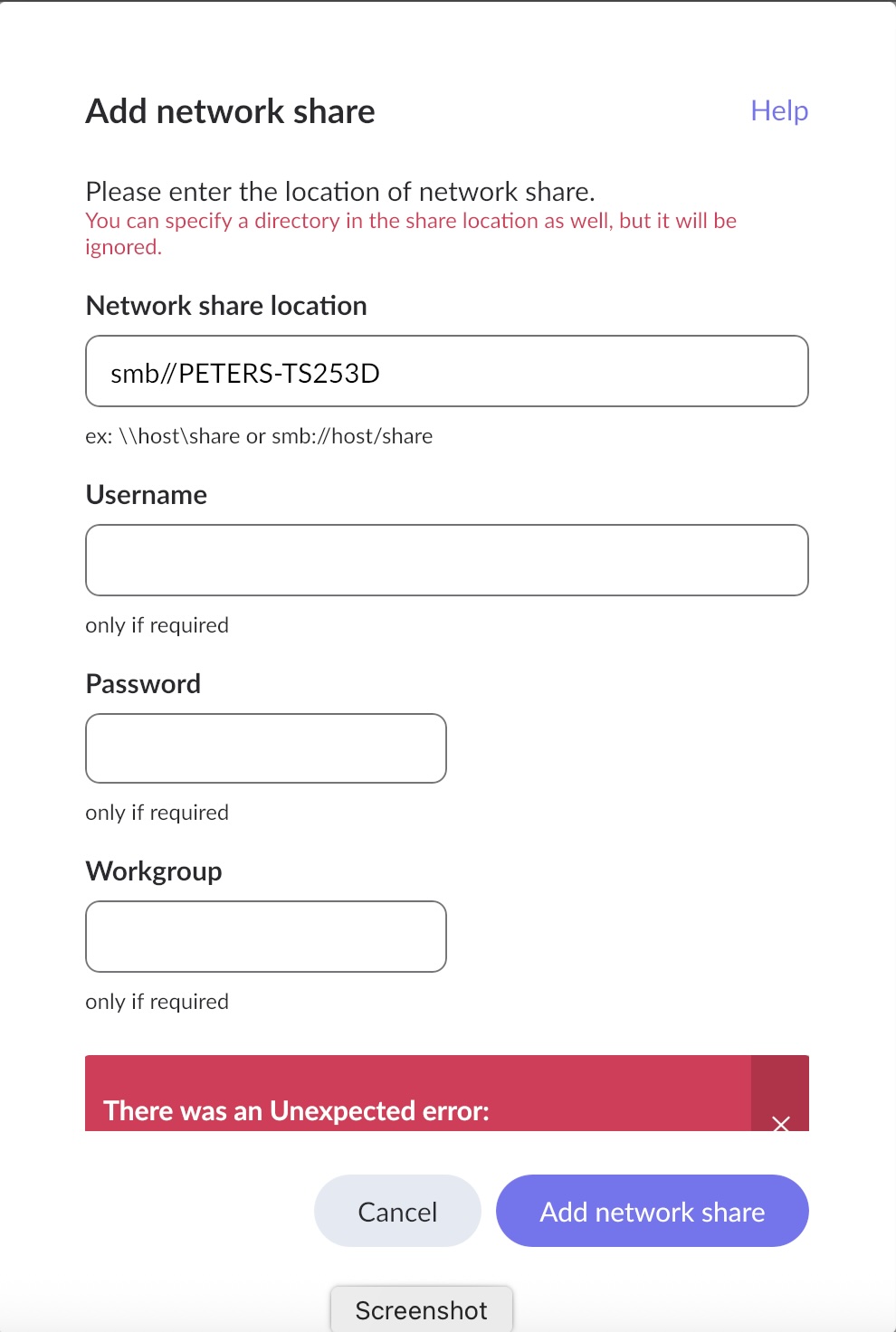

A few days ago, we had a power cut. I should add that all my music devices go through a surge protection device. However, since then my Nucleus will not source the music from my QNAP NAS. Roon showed a connection to the NAS and also to the roon backup, but it would not access any of my music and when I tried to "add the folder" again, it said it was already added. I tried going back to an old backup but although it seemed to find and apply the backup, I was still unable to source my music. I then went back to basics and reset everything on the Nucleus. However, now it appears the Nucleus/roon cannot connect to my NAS at all, whether I use the ip address, (192.168.0.19) or the device name, (//smb:PETERS-TS253D). It keeps displaying "unexpected error". I can connect to my NAS using the Qfinder Pro app and can copy music/ data from it and save elsewhere from my MacBook. I can also still use my old Meridian app to play music through my system, so the problem can't be my NAS? This is driving me mad!

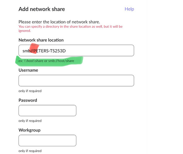

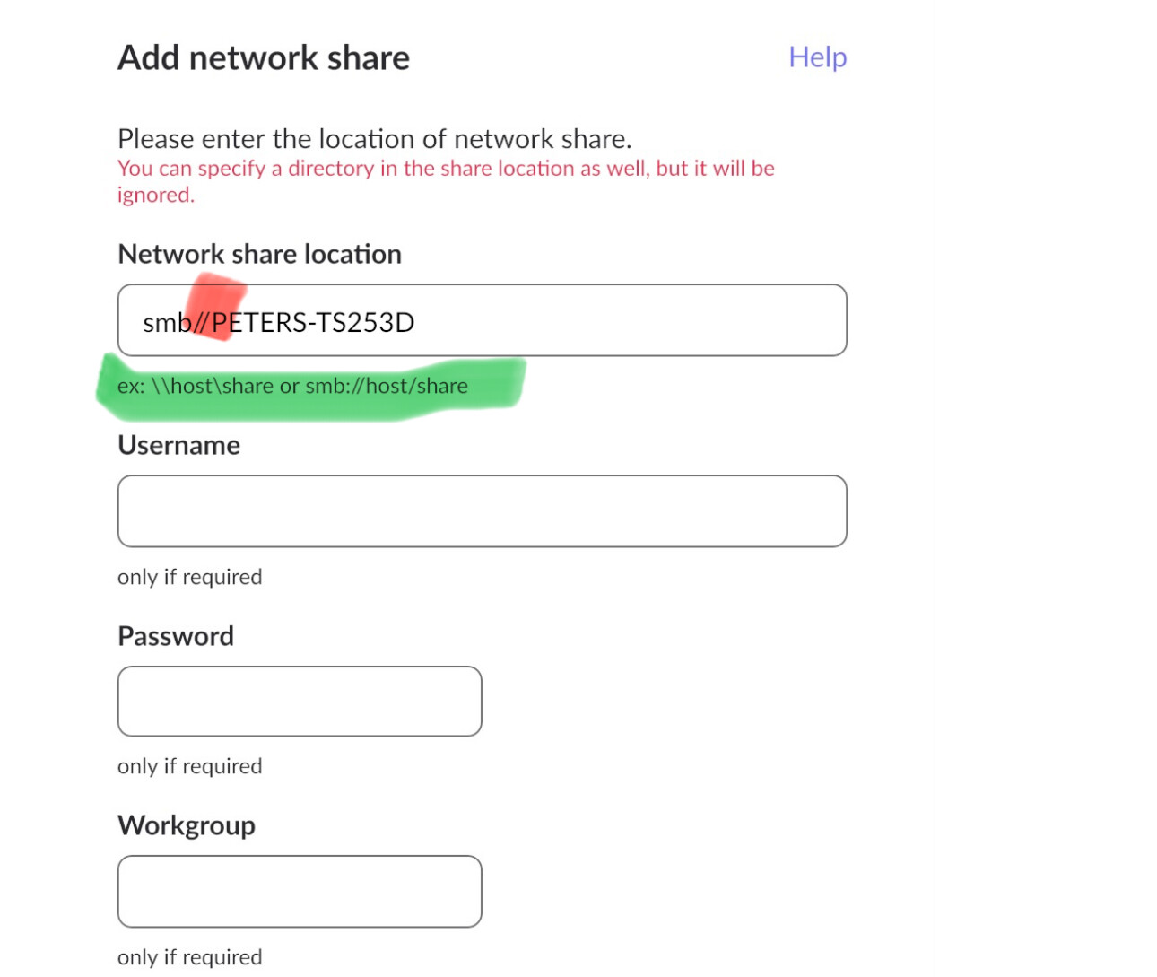

There is a colon missing in smb// :
And this is also wrong:
Note the example format below the entry box.

My apologies, the screenshot was wrong, but I have tried it with the colon, (many times), and it still doesn’t work. I have also tried with the user name and password too and that doesn’t work either.
