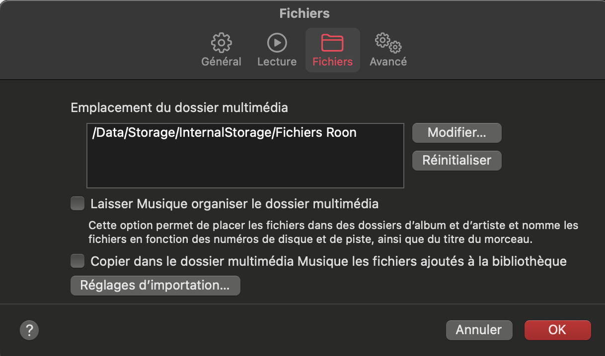

Hello everybody from France,
Please a little advice, I have the data nucleus on my Finder on how to set Apple Music to be able to read Nucleus files on Apple Music?
I did this but it doesn’t work.
You are trying to add the Nucleus’s folder as if it were a local folder on the Mac. However, this is not what it is - it is on the Nucleus and only accessible over the network.
I don’t know if this works but you could try mounting the Nucleus’s storage on the Mac with SMB (the network file access protocol) as described here under “SMB Connection (Alternate Option)”:
This makes the Nucleus’s folder accessible in Finder on the Mac, and then you might be able to access this folder from the Apple Music configuration as well - I don’t know if Apple Music can do that.
NOTE: I also don’t know if Apple Music modifies the storage that it accesses this way. Make sure that it doesn’t mess with your Nucleus folder.
