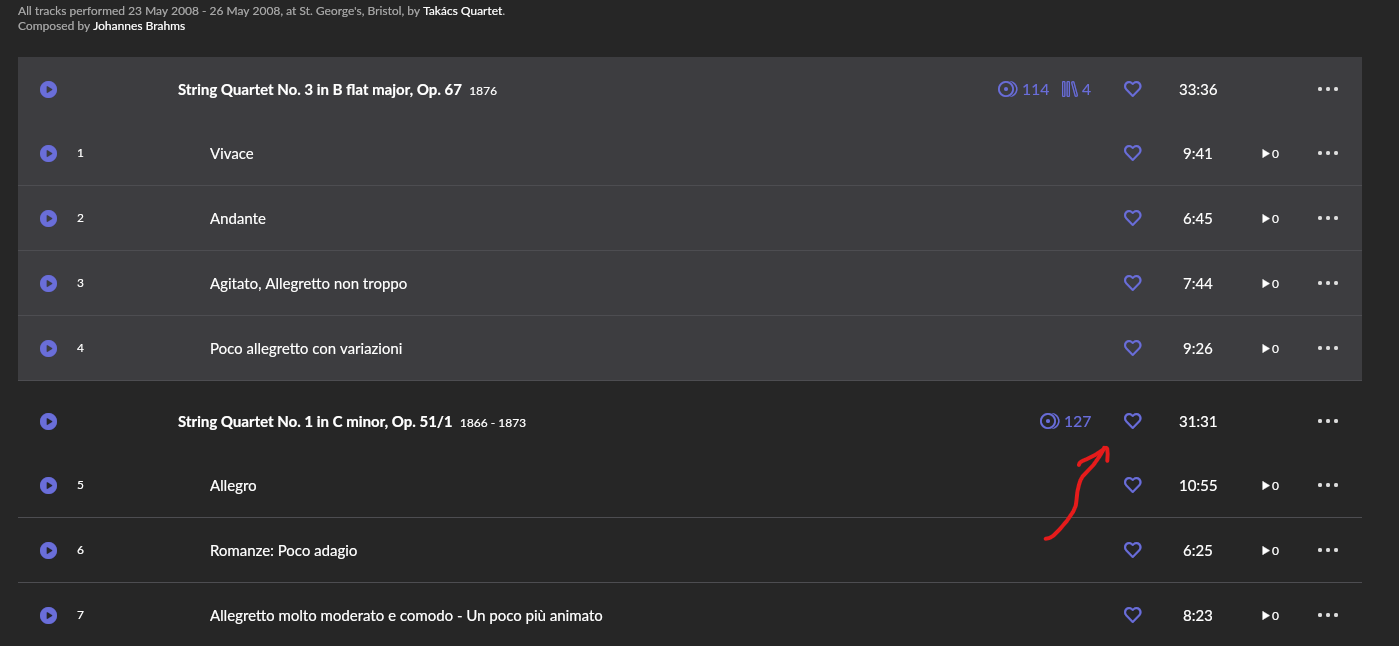

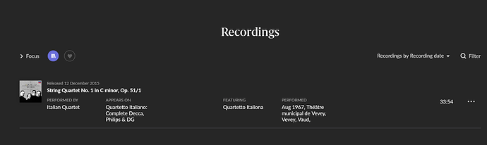

I’m seeing strange behavior with a classical composition in my library, specifically Brahms’ String Quartet No.1 (String Quartet No. 1 in C minor, Op. 51/1). I’ve been on a classical kick lately, so I never noticed before today, but until an hour or so ago Roon showed no recordings of this in my library, despite the fact that performances of the piece are identified on at least 4 albums in my library (the albums themselves are also identified). I was able to get one of the recordings to show up, but only after manually adding the work and part tags in mp3tag:

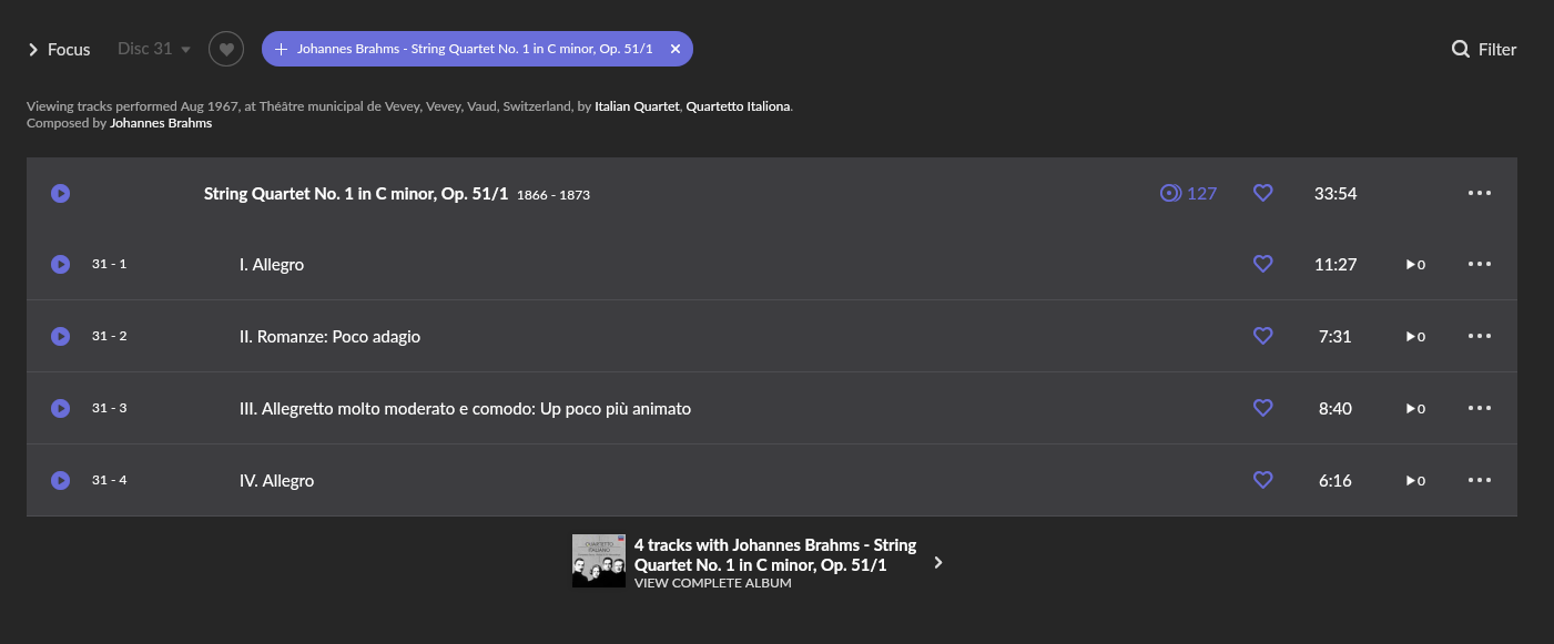

This is not the end of the world because (I think) I know the other albums that have the piece, but it is strange. This is what it looks like on an album that does not show up under the recordings. The piece is clearly identified in this album:

Right, if I click on the composiiton, or the
it should take me to the composition and there should be (or i imagine there should be)127 recordings available in Qobuz. What’s confusing me is there is not a 4, or whatever number I have in my library, next to it. The last image I posted is from the Takacs Quartet Hyperion release of the 1st and 3rd quartets. Notice that the 3rd string quartet has the 114 and a 4, which designates the number of recordings of that piece in my library.

The disc icon and number shows how many known recordings of this composition exist, including streaming… The book icon and number (which you can click as well) shows how many of those recordings are in your library.
There’s no book icon and number next to the identified composition of the String Quartet No. 1 on any of my library albums that have it identified, including the one I manually tagged to ensure the composition is identified. Roon identifies classical compositions using the TiVo/AllMusicGuide composition names, which are easy enough to look up on AllMusicGuide. As far as I can tell there’s no reason that any of the 4 instances of this composition in my library should not have the Book cover icon and the Number 4 next to it.

Arindal and mSpot, I have tried the Complete recordings option in both the on and off settings. The setting was originally set to off. No changes. oddly, once again this morning I am back to having 0 recordings in my library. I seem to have lost one other recording as well.
I’d like to thank everyone who contributed. Turns out the solution was the tried and true “turn it off and turn it back on.” 3 restarts later and we’re good:
