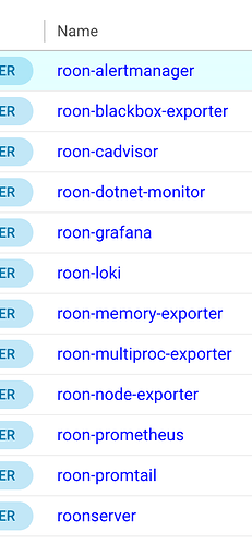

Having said that it makes things much simpler and nicer in some respects. I’ve liked using for testing and other things. It has allowed me to build up some stuff around it so that I can better track stats/data/logs/etc.

I like all the tracking you have built. ![]()
