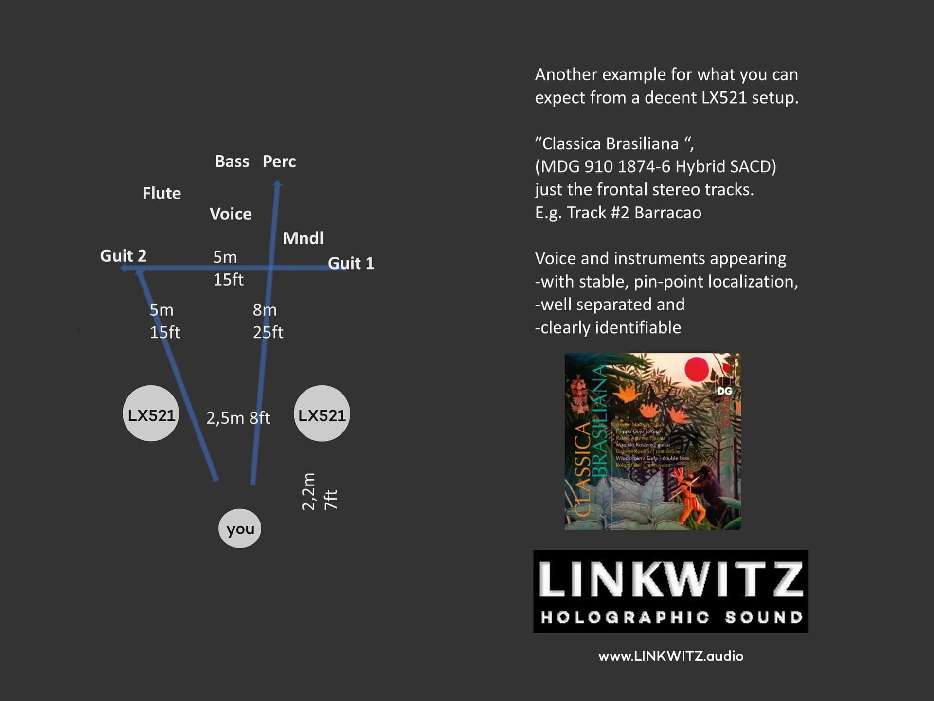

The a.m. “Classica Brasiliana”, in stereo, is not a down mix of 2+2+2, but representing just the two recorded front channels. On a fullrange dipole like Linkwitz LX521.4MG it produces a sound stage illusion like this
Arrangement/placement of instruments basically in line with the original setup (confirmed by its recording engineer Mr Dabringhaus himself, who btw. encourages his students to participate in the Minimal Microphoning Contest )
