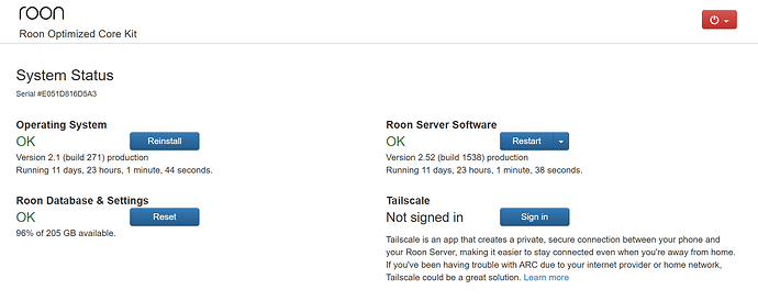

This is the current version of ROCK on my NUC.
I didn’t have to go into the BIOS to change any settings. It worked right out of the box here. Made a bootable ROCK installation USB stick. Booted the NUC from it. Had it erase the internal SSD and just set it up.
