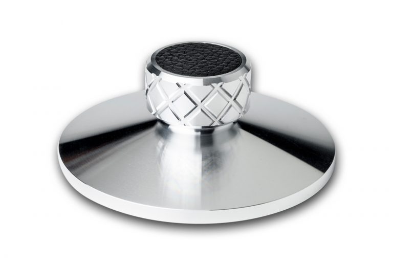

My Orbe has a screw down clamp, so if there any movement on the spindle, the record position can be set and held during playback.
There are a few tools available to make records centre on the platter, try ‘record centring tool’ as a search.

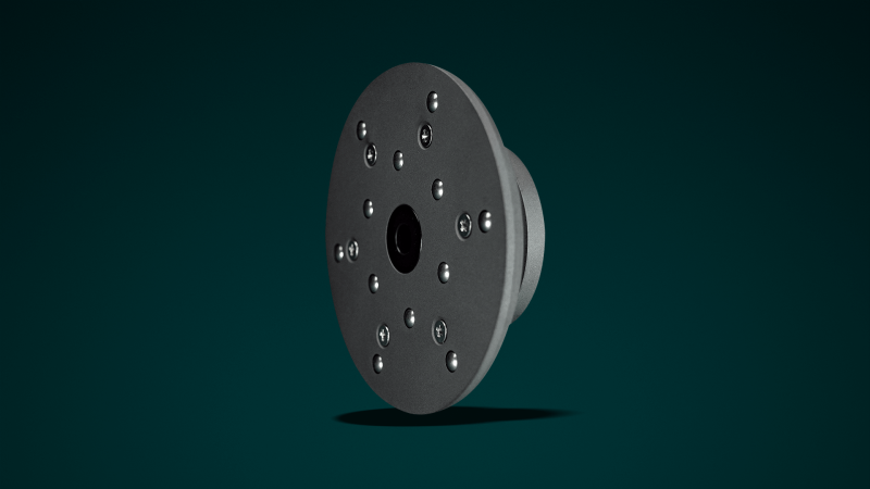

Also if you want to go wild there is the ’ DS Audio DS 001 Eccentricity Detection/Correction Device’, which sets the centring electronically.

I don’t have a clamp. Pro-Ject do a clamp that’ll fit my deck, so I guess I could give that a try.
I’d hoped to find a sleeve that would fit over the spindle. I’ll do a little more searching, and see what I come up with.

Check eBay; there are hundreds for around $30. And remember, turning parts isn’t rocket science. I bought my clamp for $25 from a Chinese seller—the wooden box was certainly worth more than the tool itself.
