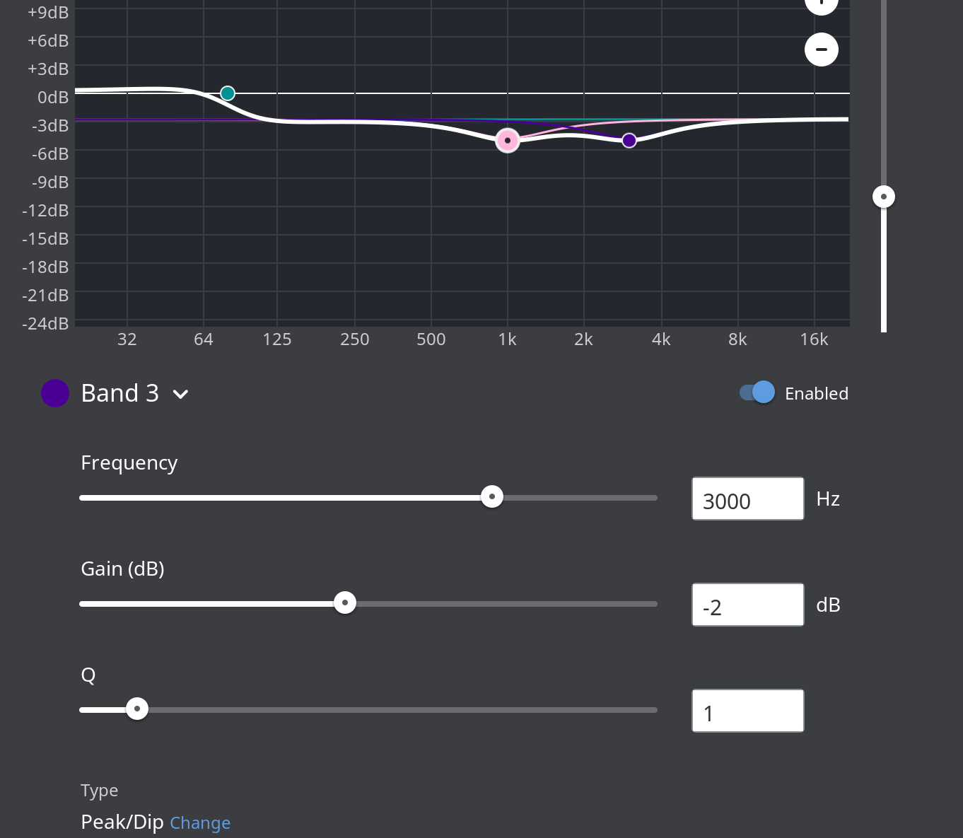

This is what I use for this exact purpose. It seems to take the edge off without losing too much detail. I’m sure others will chime in with improvements over my simple approach.
What bands have you set, filter type andq are you using, I can’t see from that image.

The picture shows five filters. The first filter, Band 1 being the large green dot, which is active in the screenshot, is a low shelf filter that isn’t doing anything (0 dB). The fifth filter, Band 5 with the purple dot, is a dip filter to -24 dB at 8kHz.

I recently changed my office setup so that was a quick and dirty first cut to keep my ears from bleeding. You’re right, it does need some tweaking.
