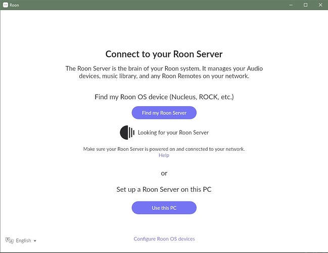

PC Roon remote stuck at 'Looking for your Roon Server' while iPhone works (ref#GQL5VH)
I have Nucleus server. My PC Roon remote stopped working yesterday – stuck at "Looking for your Roon Server".
iPhone Roon remote works, and a Naim QB2 speaker, connected on same ethernet network, works properly.
I reinstalled the Roon remote, but it didn’t solve the problem.
Standard router/modem. Nucleus connected via ethernet. Nothing change in my computer or network.
Everything was working properly until yesterday.
What happens when you click “Find my Roon Server”?

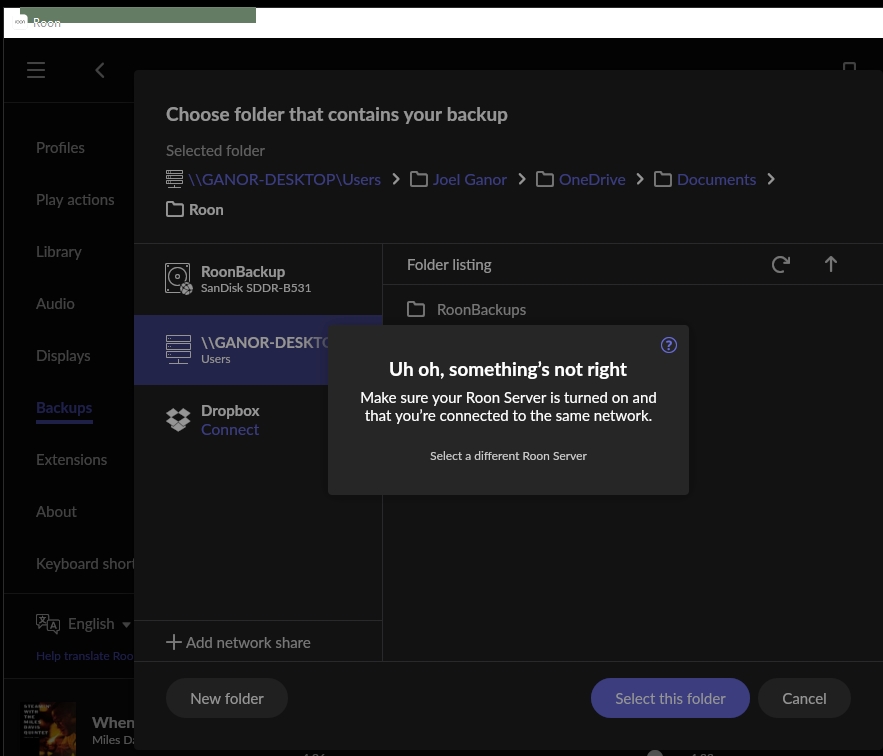

Something strange happened.
  1. I restarted my router/modem and my PC remote found Nucleus and I could connect
  2. I removed my PC backup directory and defined it again.
  3. I ran a backup to the PC directory, and it completed successfuly.
  4. Now something strange shows: the PC backup shows separately (Fig.1), and doesn’t show in the scheduled backups view (Fig. 2), and nowhere I can define the backup schedule
  5. After approximately 5 minutes, the PC remote lost connection to Nucleus (Fig.3)

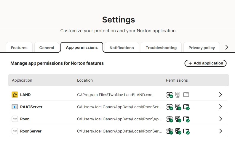

Hi Benjamin,
a) I added roon.exe to Norton’s App permissions.
b) I didn’t find any executable (.exe) file in RAATServer directory, so I couldn’t add it to App permissions.
c) PC remote worked only after restarting the router/modem, and after 7 minutes lost connection with Nucleus.
Just for your information, My PC remote worked properly long tome until recently. I didn’t changed anything in my Norton antivirus app settings. It seems to me the problem is somewhere else.

Hi Benjamin,
I added all Roon apps to Norton’s App permissions.
Remote started working only after resetting the router/modem.
After working for more than 10 minutes I was hoping the problem was resolved, but after approximately 30 minutes remote lost connection with Nycleus.
Joel
