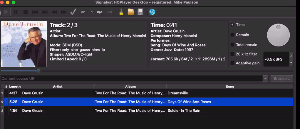

After upsampling 44khz 16 bit audio tracks in PGGB to a 705khz 64 bit wav file and adding to library, Roon skipped the tracks and reported that “Audio stream format not supported”. File size was large around 3gb. The files played directly from HQPlayer and showed the output bit depth as 64f as attached. I can send you a copy of a file if that will be helpful. (Please note, 32bit and less bit depth files with exactly the same PGGB settings import successfully.)
