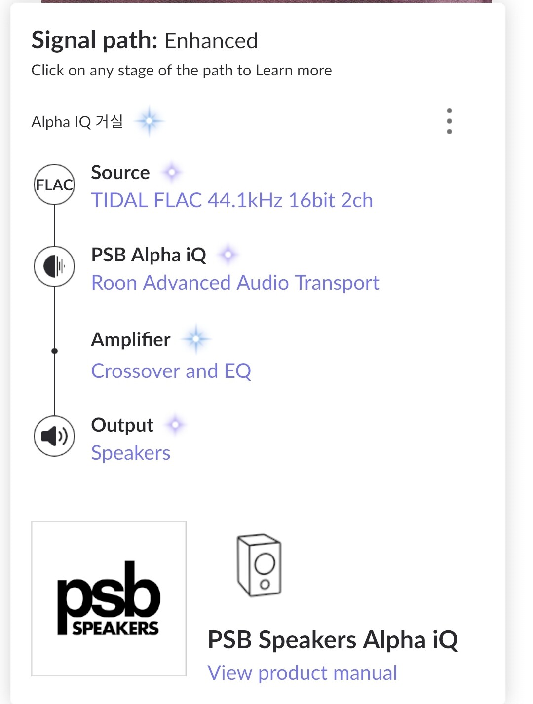

I'm using PSB alpha iq streaming speaker and there is an odd phase issue during roon playback. When I test Speaker test tracks including phase test, there is no problem in case of Tidal connect and Blusound app. In phase tracks are correctly heard and out of phase sound is correctly played. But in case of Roon playback, those tracks doesn't sound correctly. There may be a phase issue in roon playback (maybe originate from digital crossover?) in PSB alpha iq.
Please post a screenshot of your Roon signal path
Ok thanks. Something is happening after Roon, in the Amplifier stage, so it’s possible that the problem happens there. Possibly some kind of incompatibility, and the official support will have to take a look, I suppose.
In the meantime, it may be possible to work around it by inverting the phase in Roon, or at least to test if it really is a phase issue: Roon > MUSE > Add Filter > Procedural EQ > Add Operation > Invert Phase

I think it’s a complex sound phase problem. Of course, I tried inverting phase, and since the sound phase of the left and right speakers differs depending on the frequency, I believe that a phase problem occurred in the digital crossover and EQ stage of the speakers. However, there appears to be no problem at all with Tidal connect or BluOS. It appears that there is something wrong with the Roon application to this speaker.
I’ve contacted PSB support team and it has been confirmed that the left and right speakers are unbalanced when playing Roon on Alpha IQ speakers.
